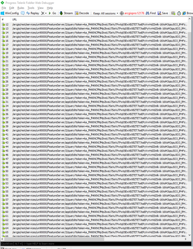

I used the Inspector class to modify multiple features, since it seems to be the preferred method on the ProSnippets documentation. However I noticed something odd when it took nearly 20 seconds to complete. I ran Fiddler to look at all the network calls to ArcGIS Server that were made during the process and saw that "applyEdits" was called once for each feature that I loaded into the inspector (see below screenshot, under code snippet), this resulted in 100 applyEdits calls and 100 queryFeature calls, 200 in total. I was expecting at most 1 call per layer.
