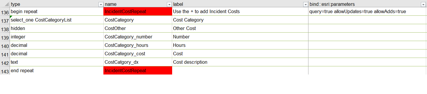

At first, we noticed that information submitted in a repeat wasn’t populated in the form when previously submitted reports were retrieved from the Inbox. After some research, we found information about how to allow queries, updates, and new records within repeats using the “bind::esri:parameters” column in the form’s configuration spreadsheet, and updated that field accordingly. The esri:parameters column is populated the same way for each repeat.

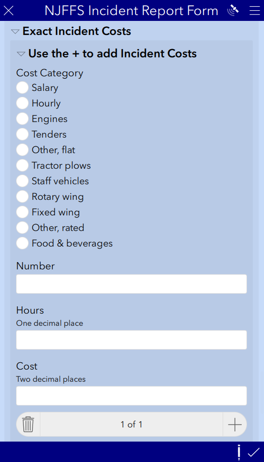

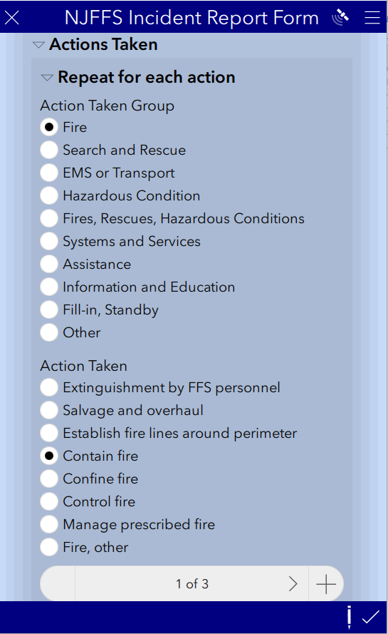

However, users are still experiencing issues pulling these related records back into the form. This issue is occurring inconsistently within the same report (some repeats come back in while some do not), and among reports (specific repeats come back into some reports but not others). Please refer to the images below for examples of successful (Actions Taken) and unsuccessful (Exact Incident Costs) queries of related records upon inbox retrieval. In the case of the Exact Incident Costs example below where the related records did not populate the form for this repeat, other repeats within the same report were populated.
