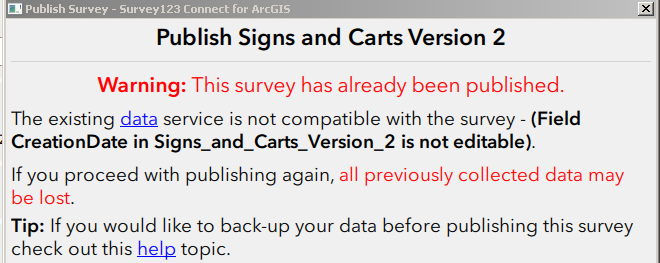

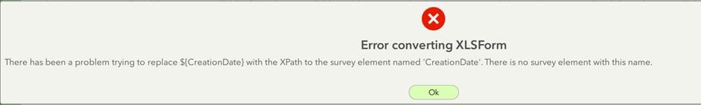

1) In my xls form, in order for me to run a calculation on the CreateDate field, the CreationDate field needs to be in the xls. Otherwise it throws an error saying there’s no CreationDate field.
When I add the field (CreationDate) with the same name, alias, field type and read only, it barks when trying to publish that CreationDate isn’t editable
Any suggestions on how to get around this?
