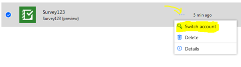

- Then find the Survey123 Connector and click on the 3 blue dots that are next to your Modified value.
- Select “Switch Account”
- Sign in using the credentials that you used to originally sign into the Flow account
After completing this, then go check out your Flows and you will notice that "all of them" have been updated to their original status. This seems to be the easiest way to reestablish the connections for "all" of the flows that I have setup.
