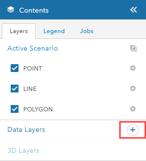

- Click the Contents icon in the upper left corner of the app. This will open the Contents pane.
- Click the + icon next to the Data Layers label. This will open the Add Data dialog.

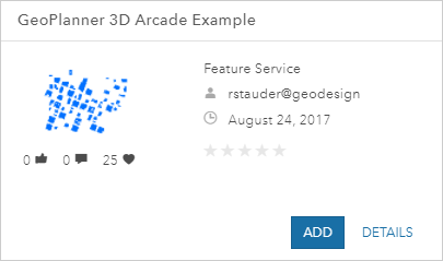

- In the search box at the top of the Add Data dialog, type in GeoPlanner 3D Arcade Example and click the All link.
- Click the Add button in the GeoPlanner 3D Arcade Example item card.

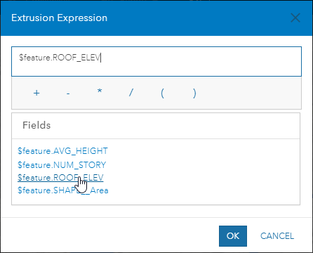

- In the 3D Settings dialog, click the Expression Builder link beneath the Extrusion Expression text box.
- In the Extrusion Expression dialog, click $feature.ROOF_ELEV. This will instruct GeoPlanner to extrude each building by the height value found in the ROOF_ELEV field.
- Click OK twice.

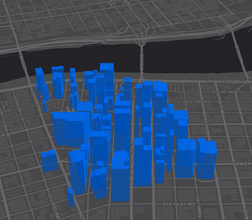

- On the map, click the Toggle to Pan or Rotate in 3D icon. Click and drag on the map to rotate or orbit around the buildings. Your map should look similar to the following graphic:

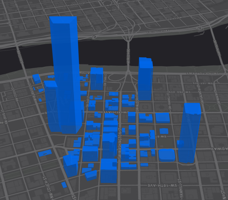

Click OK twice and use the Toggle to Pan or Rotate in 3D tool to move around your scene. Your map should look similar to the following graphic:
You'll notice that the footprints look very different now. Their extrusion represents jobs capacity instead of height, giving you a different perspective of employment potential.
