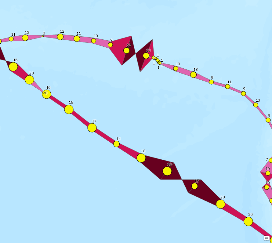

I thought it would be really cool to symbolize data from GPS tracks as a tapered line/polygon based on their attributes (I've set my sights on polygon geometry so I could eventually fill said polygons with a gradient fill thereby tying them together). I imagine this to look slighty accordian in nature with fluctuating polygon width as an attribute such as speed changes along some track (see concept image below). It's conceptually similar to the 'Tapered Line' symbol effect in ArcGIS Pro but allows for the ability to fill the polygon and vary the taper by attribute. This would allow me to do some of the data visualisation that would typically occur in graphic design software.
As it stands, the code I've written to achieve this 'nearly' work which is why I'm posting here. I've been able to create the polygons, and modify the taper but there are two main issues I've identified.
- The taper doesn't seem to always respect the attribute value that determines the width (note data points that have speed label of 17 - Center left of image, are more narrow than those that are 10, 11, 12 - Upper left of image). I suspect somethign is wonky with my equations where I calculate the offsets used to "stretch" the polygon width.
- In addition, for a reason that I cannot pin down, there are some polygons that get turned into "bowties" and become multi-part polygons when they should be quadrilaterals (from troubleshooting it seems like my Insert cursor inserted the 4th coordinate pair before the 3rd?)
If anyone has some tips, suggestions, thoughts, or if this code already exists somewhere. I'd be more than grateful to listen and learn.
Warren
Here's my code as it stands now, I've written it to run from a script tool in ArcGIS Pro (I've also attached the script and toolbox).

<SPAN class="comment token"># dx = x1 - x2</SPAN>
dx <SPAN class="operator token">=</SPAN> float<SPAN class="punctuation token">(</SPAN>feature_dictionary<SPAN class="punctuation token">[</SPAN>key<SPAN class="number token">-1</SPAN><SPAN class="punctuation token">]</SPAN><SPAN class="punctuation token">[</SPAN><SPAN class="number token">3</SPAN><SPAN class="punctuation token">]</SPAN><SPAN class="punctuation token">)</SPAN> <SPAN class="operator token">-</SPAN> float<SPAN class="punctuation token">(</SPAN>feature_dictionary<SPAN class="punctuation token">[</SPAN>key<SPAN class="operator token">+</SPAN><SPAN class="number token">1</SPAN><SPAN class="punctuation token">]</SPAN><SPAN class="punctuation token">[</SPAN><SPAN class="number token">3</SPAN><SPAN class="punctuation token">]</SPAN><SPAN class="punctuation token">)</SPAN>
<SPAN class="comment token"># Get difference of y between prior point and subsequent</SPAN>
<SPAN class="comment token"># dy = y1 - y2</SPAN>
dy <SPAN class="operator token">=</SPAN> float<SPAN class="punctuation token">(</SPAN>feature_dictionary<SPAN class="punctuation token">[</SPAN>key<SPAN class="number token">-1</SPAN><SPAN class="punctuation token">]</SPAN><SPAN class="punctuation token">[</SPAN><SPAN class="number token">4</SPAN><SPAN class="punctuation token">]</SPAN><SPAN class="punctuation token">)</SPAN> <SPAN class="operator token">-</SPAN> float<SPAN class="punctuation token">(</SPAN>feature_dictionary<SPAN class="punctuation token">[</SPAN>key<SPAN class="operator token">+</SPAN><SPAN class="number token">1</SPAN><SPAN class="punctuation token">]</SPAN><SPAN class="punctuation token">[</SPAN><SPAN class="number token">4</SPAN><SPAN class="punctuation token">]</SPAN><SPAN class="punctuation token">)</SPAN>
<SPAN class="comment token"># dist = sqrt(dx*dx + dy*dy)</SPAN>
dist <SPAN class="operator token">=</SPAN> sqrt<SPAN class="punctuation token">(</SPAN>dx <SPAN class="operator token">*</SPAN> dx <SPAN class="operator token">+</SPAN> dy <SPAN class="operator token">*</SPAN> dy<SPAN class="punctuation token">)</SPAN>
<SPAN class="comment token"># Reassign dx and dy</SPAN>
<SPAN class="keyword token">if</SPAN> dx <SPAN class="operator token">></SPAN> <SPAN class="number token">0</SPAN><SPAN class="punctuation token">:</SPAN>
dx <SPAN class="operator token">/=</SPAN> dist
<SPAN class="keyword token">else</SPAN><SPAN class="punctuation token">:</SPAN>
dx <SPAN class="operator token">=</SPAN> dx
<SPAN class="keyword token">if</SPAN> dy <SPAN class="operator token">></SPAN> <SPAN class="number token">0</SPAN><SPAN class="punctuation token">:</SPAN>
dy <SPAN class="operator token">/=</SPAN> dist
dy <SPAN class="operator token">=</SPAN> dy
<SPAN class="comment token"># Get coordinates for starting vertices (counter-clockwise starting top left)</SPAN>
<SPAN class="comment token"># x3 = x1 + (N/2)*dy</SPAN>
<SPAN class="comment token"># FACTORED</SPAN>
<SPAN class="comment token"># Bookmark primary attribute value</SPAN>
wf <SPAN class="operator token">=</SPAN> width_factor<SPAN class="punctuation token">(</SPAN>feature_dictionary<SPAN class="punctuation token">[</SPAN>key<SPAN class="punctuation token">]</SPAN><SPAN class="punctuation token">[</SPAN><SPAN class="number token">1</SPAN><SPAN class="punctuation token">]</SPAN><SPAN class="punctuation token">,</SPAN> break_dictionary<SPAN class="punctuation token">)</SPAN>
msg<SPAN class="punctuation token">(</SPAN><SPAN class="string token">'WF: {0}'</SPAN><SPAN class="punctuation token">.</SPAN>format<SPAN class="punctuation token">(</SPAN>wf<SPAN class="punctuation token">)</SPAN><SPAN class="punctuation token">)</SPAN>
<SPAN class="comment token"># Bookmark break value</SPAN>
bv <SPAN class="operator token">=</SPAN> break_dictionary<SPAN class="punctuation token">[</SPAN>wf<SPAN class="punctuation token">]</SPAN><SPAN class="punctuation token">[</SPAN><SPAN class="number token">1</SPAN><SPAN class="punctuation token">]</SPAN>
msg<SPAN class="punctuation token">(</SPAN><SPAN class="string token">'BV: {0}'</SPAN><SPAN class="punctuation token">.</SPAN>format<SPAN class="punctuation token">(</SPAN>bv<SPAN class="punctuation token">)</SPAN><SPAN class="punctuation token">)</SPAN>
x1 <SPAN class="operator token">=</SPAN> float<SPAN class="punctuation token">(</SPAN>feature_dictionary<SPAN class="punctuation token">[</SPAN>key<SPAN class="punctuation token">]</SPAN><SPAN class="punctuation token">[</SPAN><SPAN class="number token">3</SPAN><SPAN class="punctuation token">]</SPAN><SPAN class="punctuation token">)</SPAN> <SPAN class="operator token">+</SPAN> offset_calc<SPAN class="punctuation token">(</SPAN>float<SPAN class="punctuation token">(</SPAN>bv<SPAN class="punctuation token">)</SPAN><SPAN class="punctuation token">,</SPAN> <SPAN class="string token">'x'</SPAN><SPAN class="punctuation token">,</SPAN> feature_dictionary<SPAN class="punctuation token">[</SPAN>key<SPAN class="punctuation token">]</SPAN><SPAN class="punctuation token">[</SPAN><SPAN class="number token">4</SPAN><SPAN class="punctuation token">]</SPAN><SPAN class="punctuation token">)</SPAN> <SPAN class="operator token">*</SPAN> dy
y1 <SPAN class="operator token">=</SPAN> float<SPAN class="punctuation token">(</SPAN>feature_dictionary<SPAN class="punctuation token">[</SPAN>key<SPAN class="punctuation token">]</SPAN><SPAN class="punctuation token">[</SPAN><SPAN class="number token">4</SPAN><SPAN class="punctuation token">]</SPAN><SPAN class="punctuation token">)</SPAN> <SPAN class="operator token">-</SPAN> offset_calc<SPAN class="punctuation token">(</SPAN>float<SPAN class="punctuation token">(</SPAN>bv<SPAN class="punctuation token">)</SPAN><SPAN class="punctuation token">,</SPAN> <SPAN class="string token">'x'</SPAN><SPAN class="punctuation token">,</SPAN> feature_dictionary<SPAN class="punctuation token">[</SPAN>key<SPAN class="punctuation token">]</SPAN><SPAN class="punctuation token">[</SPAN><SPAN class="number token">4</SPAN><SPAN class="punctuation token">]</SPAN><SPAN class="punctuation token">)</SPAN> <SPAN class="operator token">*</SPAN> dx
x2 <SPAN class="operator token">=</SPAN> float<SPAN class="punctuation token">(</SPAN>feature_dictionary<SPAN class="punctuation token">[</SPAN>key<SPAN class="punctuation token">]</SPAN><SPAN class="punctuation token">[</SPAN><SPAN class="number token">3</SPAN><SPAN class="punctuation token">]</SPAN><SPAN class="punctuation token">)</SPAN> <SPAN class="operator token">-</SPAN> offset_calc<SPAN class="punctuation token">(</SPAN>float<SPAN class="punctuation token">(</SPAN>bv<SPAN class="punctuation token">)</SPAN><SPAN class="punctuation token">,</SPAN> <SPAN class="string token">'x'</SPAN><SPAN class="punctuation token">,</SPAN> feature_dictionary<SPAN class="punctuation token">[</SPAN>key<SPAN class="punctuation token">]</SPAN><SPAN class="punctuation token">[</SPAN><SPAN class="number token">4</SPAN><SPAN class="punctuation token">]</SPAN><SPAN class="punctuation token">)</SPAN> <SPAN class="operator token">*</SPAN> dy
y2 <SPAN class="operator token">=</SPAN> float<SPAN class="punctuation token">(</SPAN>feature_dictionary<SPAN class="punctuation token">[</SPAN>key<SPAN class="punctuation token">]</SPAN><SPAN class="punctuation token">[</SPAN><SPAN class="number token">4</SPAN><SPAN class="punctuation token">]</SPAN><SPAN class="punctuation token">)</SPAN> <SPAN class="operator token">+</SPAN> offset_calc<SPAN class="punctuation token">(</SPAN>float<SPAN class="punctuation token">(</SPAN>bv<SPAN class="punctuation token">)</SPAN><SPAN class="punctuation token">,</SPAN> <SPAN class="string token">'x'</SPAN><SPAN class="punctuation token">,</SPAN> feature_dictionary<SPAN class="punctuation token">[</SPAN>key<SPAN class="punctuation token">]</SPAN><SPAN class="punctuation token">[</SPAN><SPAN class="number token">4</SPAN><SPAN class="punctuation token">]</SPAN><SPAN class="punctuation token">)</SPAN> <SPAN class="operator token">*</SPAN> dx
<SPAN class="comment token"># Get difference of x between prior point and subsequent</SPAN>
dx2 <SPAN class="operator token">=</SPAN> float<SPAN class="punctuation token">(</SPAN>feature_dictionary<SPAN class="punctuation token">[</SPAN>key<SPAN class="punctuation token">]</SPAN><SPAN class="punctuation token">[</SPAN><SPAN class="number token">3</SPAN><SPAN class="punctuation token">]</SPAN><SPAN class="punctuation token">)</SPAN> <SPAN class="operator token">-</SPAN> float<SPAN class="punctuation token">(</SPAN>feature_dictionary<SPAN class="punctuation token">[</SPAN>key<SPAN class="operator token">+</SPAN><SPAN class="number token">2</SPAN><SPAN class="punctuation token">]</SPAN><SPAN class="punctuation token">[</SPAN><SPAN class="number token">3</SPAN><SPAN class="punctuation token">]</SPAN><SPAN class="punctuation token">)</SPAN>
dy2 <SPAN class="operator token">=</SPAN> float<SPAN class="punctuation token">(</SPAN>feature_dictionary<SPAN class="punctuation token">[</SPAN>key<SPAN class="punctuation token">]</SPAN><SPAN class="punctuation token">[</SPAN><SPAN class="number token">4</SPAN><SPAN class="punctuation token">]</SPAN><SPAN class="punctuation token">)</SPAN> <SPAN class="operator token">-</SPAN> float<SPAN class="punctuation token">(</SPAN>feature_dictionary<SPAN class="punctuation token">[</SPAN>key<SPAN class="operator token">+</SPAN><SPAN class="number token">2</SPAN><SPAN class="punctuation token">]</SPAN><SPAN class="punctuation token">[</SPAN><SPAN class="number token">4</SPAN><SPAN class="punctuation token">]</SPAN><SPAN class="punctuation token">)</SPAN>
dist2 <SPAN class="operator token">=</SPAN> sqrt<SPAN class="punctuation token">(</SPAN>dx2 <SPAN class="operator token">*</SPAN> dx2 <SPAN class="operator token">+</SPAN> dy2 <SPAN class="operator token">*</SPAN> dy2<SPAN class="punctuation token">)</SPAN>
<SPAN class="keyword token">if</SPAN> dx2 <SPAN class="operator token">></SPAN> <SPAN class="number token">0</SPAN><SPAN class="punctuation token">:</SPAN>
dx2 <SPAN class="operator token">/=</SPAN> dist2
dx2 <SPAN class="operator token">=</SPAN> dx2
<SPAN class="keyword token">if</SPAN> dy2 <SPAN class="operator token">></SPAN> <SPAN class="number token">0</SPAN><SPAN class="punctuation token">:</SPAN>
dy2 <SPAN class="operator token">/=</SPAN> dist2
dy2 <SPAN class="operator token">=</SPAN> dy2
<SPAN class="comment token"># Get coordinates for second pair</SPAN>
wf <SPAN class="operator token">=</SPAN> width_factor<SPAN class="punctuation token">(</SPAN>feature_dictionary<SPAN class="punctuation token">[</SPAN>key<SPAN class="operator token">+</SPAN><SPAN class="number token">1</SPAN><SPAN class="punctuation token">]</SPAN><SPAN class="punctuation token">[</SPAN><SPAN class="number token">1</SPAN><SPAN class="punctuation token">]</SPAN><SPAN class="punctuation token">,</SPAN> break_dictionary<SPAN class="punctuation token">)</SPAN>
msg<SPAN class="punctuation token">(</SPAN><SPAN class="string token">'WF2: {0}'</SPAN><SPAN class="punctuation token">.</SPAN>format<SPAN class="punctuation token">(</SPAN>wf<SPAN class="punctuation token">)</SPAN><SPAN class="punctuation token">)</SPAN>
msg<SPAN class="punctuation token">(</SPAN><SPAN class="string token">'BV2: {0}'</SPAN><SPAN class="punctuation token">.</SPAN>format<SPAN class="punctuation token">(</SPAN>bv<SPAN class="punctuation token">)</SPAN><SPAN class="punctuation token">)</SPAN>
x3 <SPAN class="operator token">=</SPAN> float<SPAN class="punctuation token">(</SPAN>feature_dictionary<SPAN class="punctuation token">[</SPAN>key<SPAN class="operator token">+</SPAN><SPAN class="number token">1</SPAN><SPAN class="punctuation token">]</SPAN><SPAN class="punctuation token">[</SPAN><SPAN class="number token">3</SPAN><SPAN class="punctuation token">]</SPAN><SPAN class="punctuation token">)</SPAN> <SPAN class="operator token">+</SPAN> offset_calc<SPAN class="punctuation token">(</SPAN>float<SPAN class="punctuation token">(</SPAN>bv<SPAN class="punctuation token">)</SPAN><SPAN class="punctuation token">,</SPAN> <SPAN class="string token">'x'</SPAN><SPAN class="punctuation token">,</SPAN> feature_dictionary<SPAN class="punctuation token">[</SPAN>key<SPAN class="operator token">+</SPAN><SPAN class="number token">1</SPAN><SPAN class="punctuation token">]</SPAN><SPAN class="punctuation token">[</SPAN><SPAN class="number token">4</SPAN><SPAN class="punctuation token">]</SPAN><SPAN class="punctuation token">)</SPAN> <SPAN class="operator token">*</SPAN> dy2
y3 <SPAN class="operator token">=</SPAN> float<SPAN class="punctuation token">(</SPAN>feature_dictionary<SPAN class="punctuation token">[</SPAN>key<SPAN class="operator token">+</SPAN><SPAN class="number token">1</SPAN><SPAN class="punctuation token">]</SPAN><SPAN class="punctuation token">[</SPAN><SPAN class="number token">4</SPAN><SPAN class="punctuation token">]</SPAN><SPAN class="punctuation token">)</SPAN> <SPAN class="operator token">-</SPAN> offset_calc<SPAN class="punctuation token">(</SPAN>float<SPAN class="punctuation token">(</SPAN>bv<SPAN class="punctuation token">)</SPAN><SPAN class="punctuation token">,</SPAN> <SPAN class="string token">'x'</SPAN><SPAN class="punctuation token">,</SPAN> feature_dictionary<SPAN class="punctuation token">[</SPAN>key<SPAN class="operator token">+</SPAN><SPAN class="number token">1</SPAN><SPAN class="punctuation token">]</SPAN><SPAN class="punctuation token">[</SPAN><SPAN class="number token">4</SPAN><SPAN class="punctuation token">]</SPAN><SPAN class="punctuation token">)</SPAN> <SPAN class="operator token">*</SPAN> dx2
x4 <SPAN class="operator token">=</SPAN> float<SPAN class="punctuation token">(</SPAN>feature_dictionary<SPAN class="punctuation token">[</SPAN>key<SPAN class="operator token">+</SPAN><SPAN class="number token">1</SPAN><SPAN class="punctuation token">]</SPAN><SPAN class="punctuation token">[</SPAN><SPAN class="number token">3</SPAN><SPAN class="punctuation token">]</SPAN><SPAN class="punctuation token">)</SPAN> <SPAN class="operator token">-</SPAN> offset_calc<SPAN class="punctuation token">(</SPAN>float<SPAN class="punctuation token">(</SPAN>bv<SPAN class="punctuation token">)</SPAN><SPAN class="punctuation token">,</SPAN> <SPAN class="string token">'x'</SPAN><SPAN class="punctuation token">,</SPAN> feature_dictionary<SPAN class="punctuation token">[</SPAN>key<SPAN class="operator token">+</SPAN><SPAN class="number token">1</SPAN><SPAN class="punctuation token">]</SPAN><SPAN class="punctuation token">[</SPAN><SPAN class="number token">4</SPAN><SPAN class="punctuation token">]</SPAN><SPAN class="punctuation token">)</SPAN> <SPAN class="operator token">*</SPAN> dy2
y4 <SPAN class="operator token">=</SPAN> float<SPAN class="punctuation token">(</SPAN>feature_dictionary<SPAN class="punctuation token">[</SPAN>key<SPAN class="operator token">+</SPAN><SPAN class="number token">1</SPAN><SPAN class="punctuation token">]</SPAN><SPAN class="punctuation token">[</SPAN><SPAN class="number token">4</SPAN><SPAN class="punctuation token">]</SPAN><SPAN class="punctuation token">)</SPAN> <SPAN class="operator token">+</SPAN> offset_calc<SPAN class="punctuation token">(</SPAN>float<SPAN class="punctuation token">(</SPAN>bv<SPAN class="punctuation token">)</SPAN><SPAN class="punctuation token">,</SPAN> <SPAN class="string token">'x'</SPAN><SPAN class="punctuation token">,</SPAN> feature_dictionary<SPAN class="punctuation token">[</SPAN>key<SPAN class="operator token">+</SPAN><SPAN class="number token">1</SPAN><SPAN class="punctuation token">]</SPAN><SPAN class="punctuation token">[</SPAN><SPAN class="number token">4</SPAN><SPAN class="punctuation token">]</SPAN><SPAN class="punctuation token">)</SPAN> <SPAN class="operator token">*</SPAN> dx2
<SPAN class="comment token"># Create feature</SPAN>
coordinates <SPAN class="operator token">=</SPAN> <SPAN class="punctuation token">[</SPAN><SPAN class="punctuation token">(</SPAN>float<SPAN class="punctuation token">(</SPAN>x1<SPAN class="punctuation token">)</SPAN><SPAN class="punctuation token">,</SPAN> float<SPAN class="punctuation token">(</SPAN>y1<SPAN class="punctuation token">)</SPAN><SPAN class="punctuation token">)</SPAN><SPAN class="punctuation token">,</SPAN> <SPAN class="punctuation token">(</SPAN>float<SPAN class="punctuation token">(</SPAN>x2<SPAN class="punctuation token">)</SPAN><SPAN class="punctuation token">,</SPAN> float<SPAN class="punctuation token">(</SPAN>y2<SPAN class="punctuation token">)</SPAN><SPAN class="punctuation token">)</SPAN><SPAN class="punctuation token">,</SPAN> <SPAN class="punctuation token">(</SPAN>float<SPAN class="punctuation token">(</SPAN>x4<SPAN class="punctuation token">)</SPAN><SPAN class="punctuation token">,</SPAN> float<SPAN class="punctuation token">(</SPAN>y4<SPAN class="punctuation token">)</SPAN><SPAN class="punctuation token">)</SPAN><SPAN class="punctuation token">,</SPAN> <SPAN class="punctuation token">(</SPAN>float<SPAN class="punctuation token">(</SPAN>x3<SPAN class="punctuation token">)</SPAN><SPAN class="punctuation token">,</SPAN> float<SPAN class="punctuation token">(</SPAN>y3<SPAN class="punctuation token">)</SPAN><SPAN class="punctuation token">)</SPAN><SPAN class="punctuation token">]</SPAN>
<SPAN class="keyword token">try</SPAN><SPAN class="punctuation token">:</SPAN>
msg<SPAN class="punctuation token">(</SPAN><SPAN class="string token">'Attempting insert'</SPAN><SPAN class="punctuation token">)</SPAN>
<SPAN class="comment token"># 'OBJECTID', primary_param, secondary_param, 'SHAPE@X', 'SHAPE@Y'</SPAN>
<SPAN class="comment token"># 'LINE_FID', 'PRIMARY_VALUE', 'PRIMARY_CLASSED', 'SECONDARY_VALUE', 'SHAPE@'</SPAN>
data <SPAN class="operator token">=</SPAN> <SPAN class="punctuation token">[</SPAN>feature_dictionary<SPAN class="punctuation token">[</SPAN>key<SPAN class="punctuation token">]</SPAN><SPAN class="punctuation token">[</SPAN><SPAN class="number token">0</SPAN><SPAN class="punctuation token">]</SPAN><SPAN class="punctuation token">,</SPAN> feature_dictionary<SPAN class="punctuation token">[</SPAN>key<SPAN class="punctuation token">]</SPAN><SPAN class="punctuation token">[</SPAN><SPAN class="number token">1</SPAN><SPAN class="punctuation token">]</SPAN><SPAN class="punctuation token">,</SPAN> width_factor<SPAN class="punctuation token">(</SPAN>feature_dictionary<SPAN class="punctuation token">[</SPAN>key<SPAN class="punctuation token">]</SPAN><SPAN class="punctuation token">[</SPAN><SPAN class="number token">1</SPAN><SPAN class="punctuation token">]</SPAN><SPAN class="punctuation token">,</SPAN> break_dictionary<SPAN class="punctuation token">)</SPAN><SPAN class="punctuation token">,</SPAN> feature_dictionary<SPAN class="punctuation token">[</SPAN>key<SPAN class="punctuation token">]</SPAN><SPAN class="punctuation token">[</SPAN><SPAN class="number token">2</SPAN><SPAN class="punctuation token">]</SPAN><SPAN class="punctuation token">,</SPAN> coordinates<SPAN class="punctuation token">]</SPAN>
msg<SPAN class="punctuation token">(</SPAN>data<SPAN class="punctuation token">)</SPAN>
i_cursor<SPAN class="punctuation token">.</SPAN>insertRow<SPAN class="punctuation token">(</SPAN>data<SPAN class="punctuation token">)</SPAN>
<SPAN class="keyword token">except</SPAN><SPAN class="punctuation token">:</SPAN>
e <SPAN class="operator token">=</SPAN> sys<SPAN class="punctuation token">.</SPAN>exc_info<SPAN class="punctuation token">(</SPAN><SPAN class="punctuation token">)</SPAN><SPAN class="punctuation token">[</SPAN><SPAN class="number token">1</SPAN><SPAN class="punctuation token">]</SPAN>
msg<SPAN class="punctuation token">(</SPAN><SPAN class="string token">'Insert failed: {0}'</SPAN><SPAN class="punctuation token">.</SPAN>format<SPAN class="punctuation token">(</SPAN>e<SPAN class="punctuation token">.</SPAN>args<SPAN class="punctuation token">[</SPAN><SPAN class="number token">0</SPAN><SPAN class="punctuation token">]</SPAN><SPAN class="punctuation token">)</SPAN><SPAN class="punctuation token">)</SPAN><SPAN class="line-numbers-rows"><SPAN></SPAN><SPAN></SPAN><SPAN></SPAN><SPAN></SPAN><SPAN></SPAN><SPAN></SPAN><SPAN></SPAN><SPAN></SPAN><SPAN></SPAN><SPAN></SPAN><SPAN></SPAN><SPAN></SPAN><SPAN></SPAN><SPAN></SPAN><SPAN></SPAN><SPAN></SPAN><SPAN></SPAN><SPAN></SPAN><SPAN></SPAN><SPAN></SPAN><SPAN></SPAN><SPAN></SPAN><SPAN></SPAN><SPAN></SPAN><SPAN></SPAN><SPAN></SPAN><SPAN></SPAN><SPAN></SPAN><SPAN></SPAN><SPAN></SPAN><SPAN></SPAN><SPAN></SPAN><SPAN></SPAN><SPAN></SPAN><SPAN></SPAN><SPAN></SPAN><SPAN></SPAN><SPAN></SPAN><SPAN></SPAN><SPAN></SPAN><SPAN></SPAN><SPAN></SPAN><SPAN></SPAN><SPAN></SPAN><SPAN></SPAN><SPAN></SPAN><SPAN></SPAN><SPAN></SPAN><SPAN></SPAN><SPAN></SPAN><SPAN></SPAN><SPAN></SPAN><SPAN></SPAN><SPAN></SPAN><SPAN></SPAN><SPAN></SPAN><SPAN></SPAN><SPAN></SPAN><SPAN></SPAN><SPAN></SPAN><SPAN></SPAN><SPAN></SPAN><SPAN></SPAN><SPAN></SPAN><SPAN></SPAN><SPAN></SPAN><SPAN></SPAN><SPAN></SPAN><SPAN></SPAN><SPAN></SPAN><SPAN></SPAN><SPAN></SPAN><SPAN></SPAN><SPAN></SPAN><SPAN></SPAN><SPAN></SPAN><SPAN></SPAN><SPAN></SPAN><SPAN></SPAN><SPAN></SPAN><SPAN></SPAN><SPAN></SPAN><SPAN></SPAN><SPAN></SPAN><SPAN></SPAN><SPAN></SPAN><SPAN></SPAN><SPAN></SPAN><SPAN></SPAN><SPAN></SPAN><SPAN></SPAN><SPAN></SPAN><SPAN></SPAN><SPAN></SPAN><SPAN></SPAN><SPAN></SPAN><SPAN></SPAN><SPAN></SPAN><SPAN></SPAN><SPAN></SPAN><SPAN></SPAN><SPAN></SPAN><SPAN></SPAN><SPAN></SPAN><SPAN></SPAN><SPAN></SPAN><SPAN></SPAN><SPAN></SPAN><SPAN></SPAN><SPAN></SPAN><SPAN></SPAN><SPAN></SPAN><SPAN></SPAN><SPAN></SPAN><SPAN></SPAN><SPAN></SPAN><SPAN></SPAN><SPAN></SPAN><SPAN></SPAN><SPAN></SPAN><SPAN></SPAN><SPAN></SPAN><SPAN></SPAN><SPAN></SPAN><SPAN></SPAN><SPAN></SPAN><SPAN></SPAN><SPAN></SPAN><SPAN></SPAN><SPAN></SPAN><SPAN></SPAN><SPAN></SPAN><SPAN></SPAN><SPAN></SPAN><SPAN></SPAN><SPAN></SPAN><SPAN></SPAN><SPAN></SPAN><SPAN></SPAN><SPAN></SPAN><SPAN></SPAN><SPAN></SPAN><SPAN></SPAN><SPAN></SPAN><SPAN></SPAN><SPAN></SPAN><SPAN></SPAN><SPAN></SPAN><SPAN></SPAN><SPAN></SPAN><SPAN></SPAN><SPAN></SPAN><SPAN></SPAN><SPAN></SPAN><SPAN></SPAN><SPAN></SPAN><SPAN></SPAN><SPAN></SPAN><SPAN></SPAN><SPAN></SPAN><SPAN></SPAN><SPAN></SPAN><SPAN></SPAN><SPAN></SPAN><SPAN></SPAN><SPAN></SPAN><SPAN></SPAN><SPAN></SPAN><SPAN></SPAN><SPAN></SPAN><SPAN></SPAN><SPAN></SPAN><SPAN></SPAN><SPAN></SPAN><SPAN></SPAN><SPAN></SPAN><SPAN></SPAN><SPAN></SPAN><SPAN></SPAN><SPAN></SPAN><SPAN></SPAN><SPAN></SPAN><SPAN></SPAN><SPAN></SPAN><SPAN></SPAN><SPAN></SPAN><SPAN></SPAN><SPAN></SPAN><SPAN></SPAN><SPAN></SPAN><SPAN></SPAN><SPAN></SPAN><SPAN></SPAN><SPAN></SPAN><SPAN></SPAN><SPAN></SPAN><SPAN></SPAN><SPAN></SPAN><SPAN></SPAN><SPAN></SPAN><SPAN></SPAN><SPAN></SPAN><SPAN></SPAN><SPAN></SPAN><SPAN></SPAN><SPAN></SPAN><SPAN></SPAN><SPAN></SPAN><SPAN></SPAN><SPAN></SPAN><SPAN></SPAN><SPAN></SPAN><SPAN></SPAN><SPAN></SPAN><SPAN></SPAN><SPAN></SPAN><SPAN></SPAN><SPAN></SPAN><SPAN></SPAN><SPAN></SPAN><SPAN></SPAN><SPAN></SPAN><SPAN></SPAN><SPAN></SPAN></SPAN>
