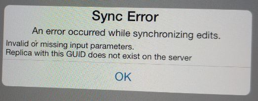

I could live with orphaned replicas that require manual cleanup, but this same iPad keeps throwing this error message when the user syncs his edits:
And let's just make this a bit more confusing: his edits actually do sync into the associated version and we can reconcile and post with no problem. But Collector thinks that the edits did not go through.
Bottom line is that I need the iPad to reliably sync with no error messages when the user comes back in from the field. I don't know if the orphaned replica has anything to do with our error messages, but I'm at a loss on what to try at this point.
