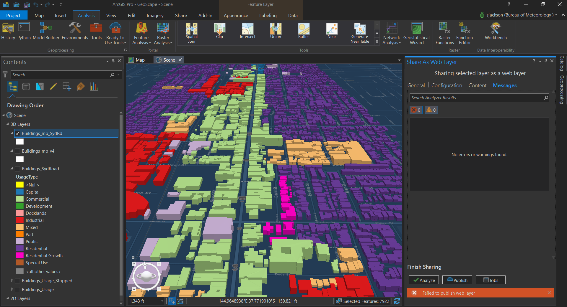

Can anyone help me troubleshoot publishing Scene Layers from ArcGIS Pro 2.0 to a 10.5.1 instance.
“Error executing tool. Publish Portal Service Job ID: jf64ff193514d40fe84bc8313c04c484c : ERROR 001369: Failed to create the service. Failed to execute (PublishServiceDefinition). Failed to execute (Publish Portal Service).”
BUG-000107828

Windows 10 Enterprise.
Fresh install of ArcGIS Enterprise 10.5.1 using the builder, applied domain certs to IIS.
Have also enabled the ‘Use SSL 3.0’ on the ArcGIS system account as per:
http://support.esri.com/en/Technical-Article/000016013
But still get the same issue.

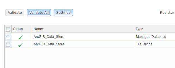

Also noticed that if I login to the portal as the portal administrator
My Content --> Create a Feature Layer -> Pick Any template = ERROR IN OPENING WORKSPACE
Suggests something might be up with the ArcGIS Data Store.
Have sent through my logs to support and will update this ticket with the outcome.
