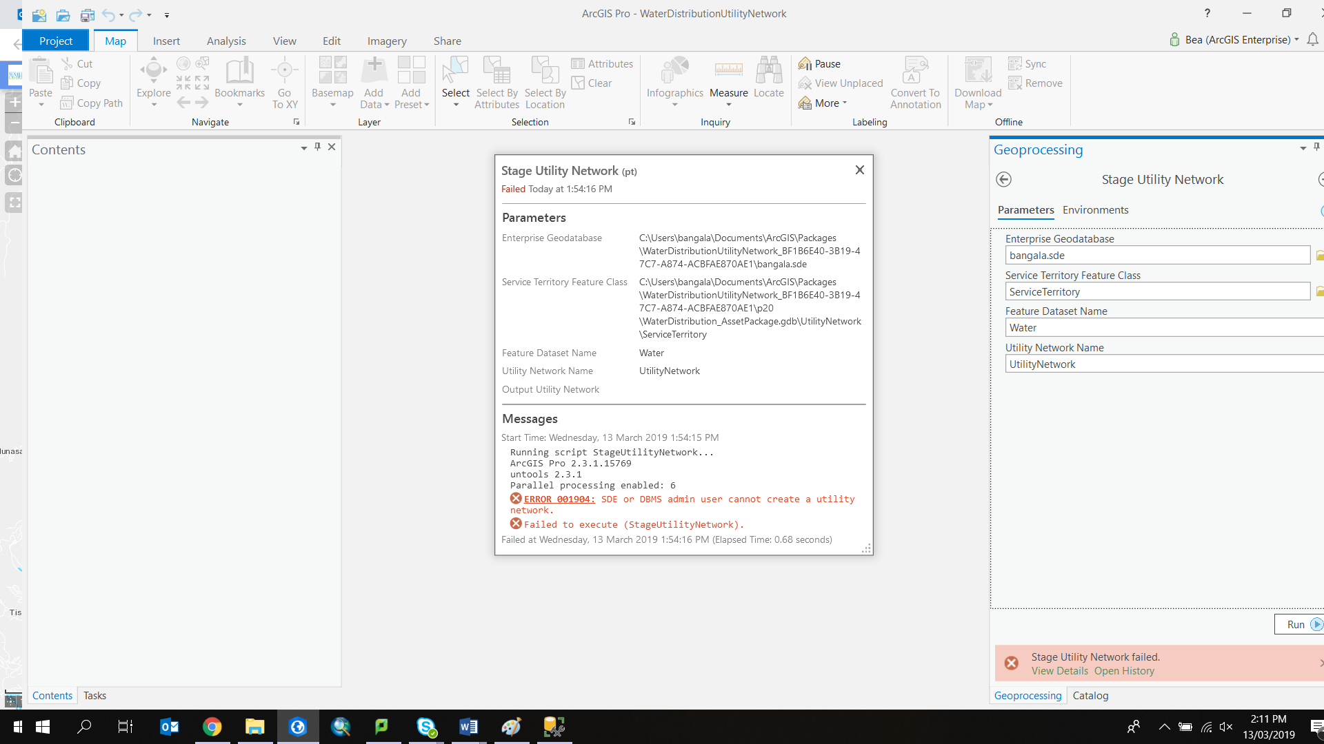

I'm trying to deploy the Water Utility Network solution. I followed all the steps from (1) Creating an Enterprise Geodatabase, (2) Creating a Database User, and (3) Changing the connection properties of the enterprise geodatabase to the new database user. When I run the tool Stage Utility Network I get the error "ERROR 001904: SDE or DBMS admin user cannot create a utility network."

SQL Server 2016. I'm connected to as the new database user I created. I'm used ArcGIS Pro 2.3.1 when I got the error. I downgraded to 2.2.0 and the Stage Utility Network worked fine.
