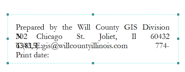

Using ArcMap 10.5.1 and Python 2.7, I have a script that finds a text box in map layout of an MXD(s) by two key words "PRINT DATE" and changes the text to new text. I believe the script is doing what I want it to and it runs with no error. However, the resulting text in the text box is illegible.

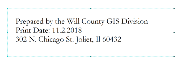

Text box before:
and after:

Print out:
Prepared by the Will County GIS Division
Print Date: 11.2.2018
302 N. Chicago St. Joliet, Il 60432

6. I know the script works. I tested the script on a new MXD with similar text in a text box. The script ran fine and the resulting new text was displayed correctly! I also had a second text box in the MXD that had the word "date" among the text . I ran the script once with only "DATE" as a key word and it found both text boxes. It knowingly changed both. The odd thing was that while the one I'm after came out illegible again, the second text box was displayed correctly!
I'm wondering if anyone has seen this behaviour before?
