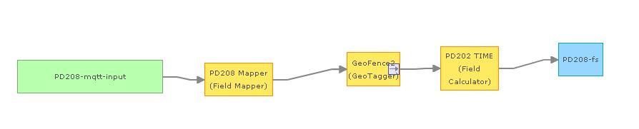

GE is duplicating large amounts of messages between the input and output. The input and outputs are not connected in any other service besides the one below. Has anyone had this happen or know how to fix it?
Single Machine Deployment
Geoevent 10.6.1
windows R2 2012

We discovered that our antivirus software (Cylance) was interfering with geoevent. We are working to figure out exacting what is going on but if Cylance is set to default (basically off) then geoevent performs as expected.
