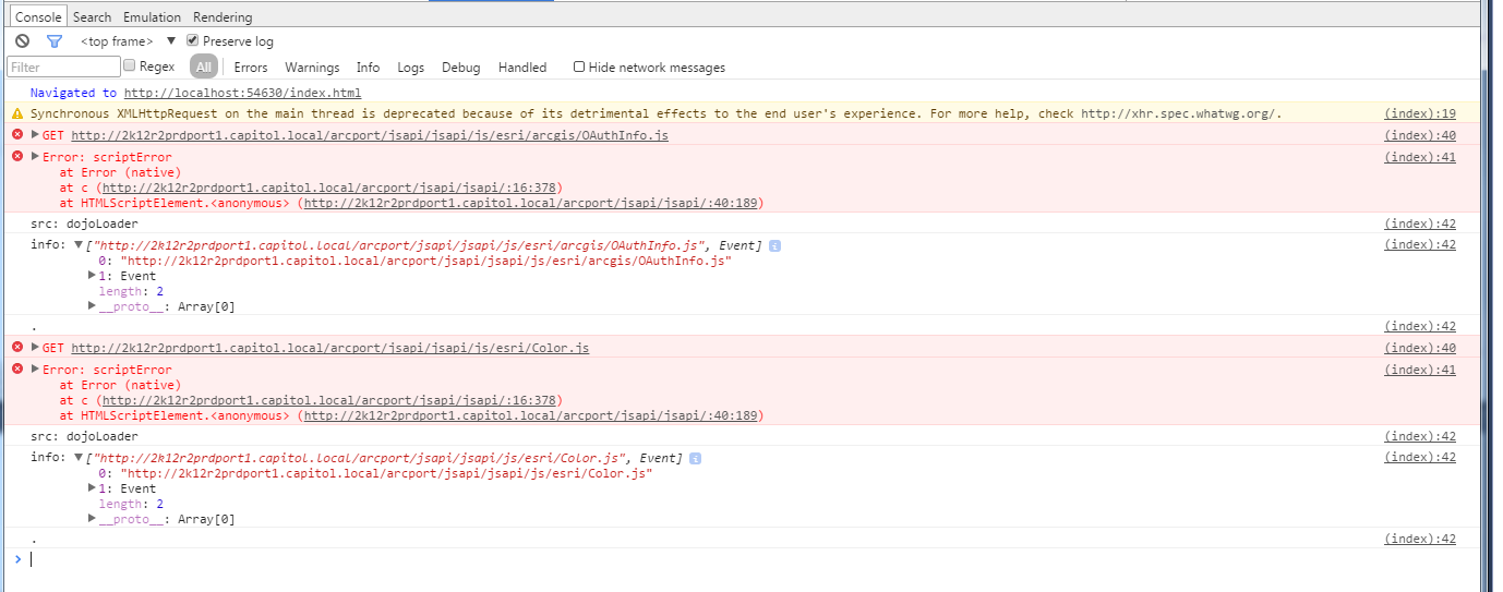

I have obtained the Viewer application from GitHub and added a module that supports map navigation by legislative district. The application works perfectly for ArcGIS Online versions of our maps, but not Portal. In index.html I have configured references to the JavaScript libraries to point to our server, as instructed in the liner notes, but the application fails for "404" reasons.
<script type="text/javascript" src="//......capitol.local/arcport/jsapi/jsapi"></script>
The JavaScript code is present in the app at run time, so now I have questions about whether I am actually missing something in the libraries. What is wrong with this picture? I do explicitly add a reference to color.js in the code I added, but haven't done anything with "oAuthInfo."
