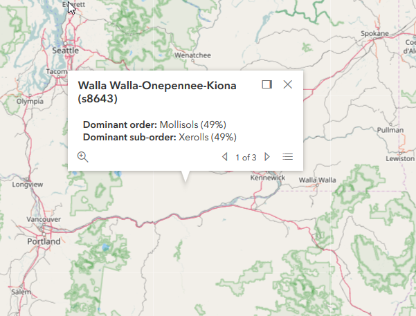

Hi!
Is it normal that the IdentifyTask returns features even if the layer is not visible? I see in the documentation that the layerOption parameter in the IdentifyParameters should define if the IdentifyTask will return feature for visibile layer only. However, this parameter seem not working. The popup is displayed even if the layer is not visible as shown below. The image and code below are taken from the documentation sample codes
