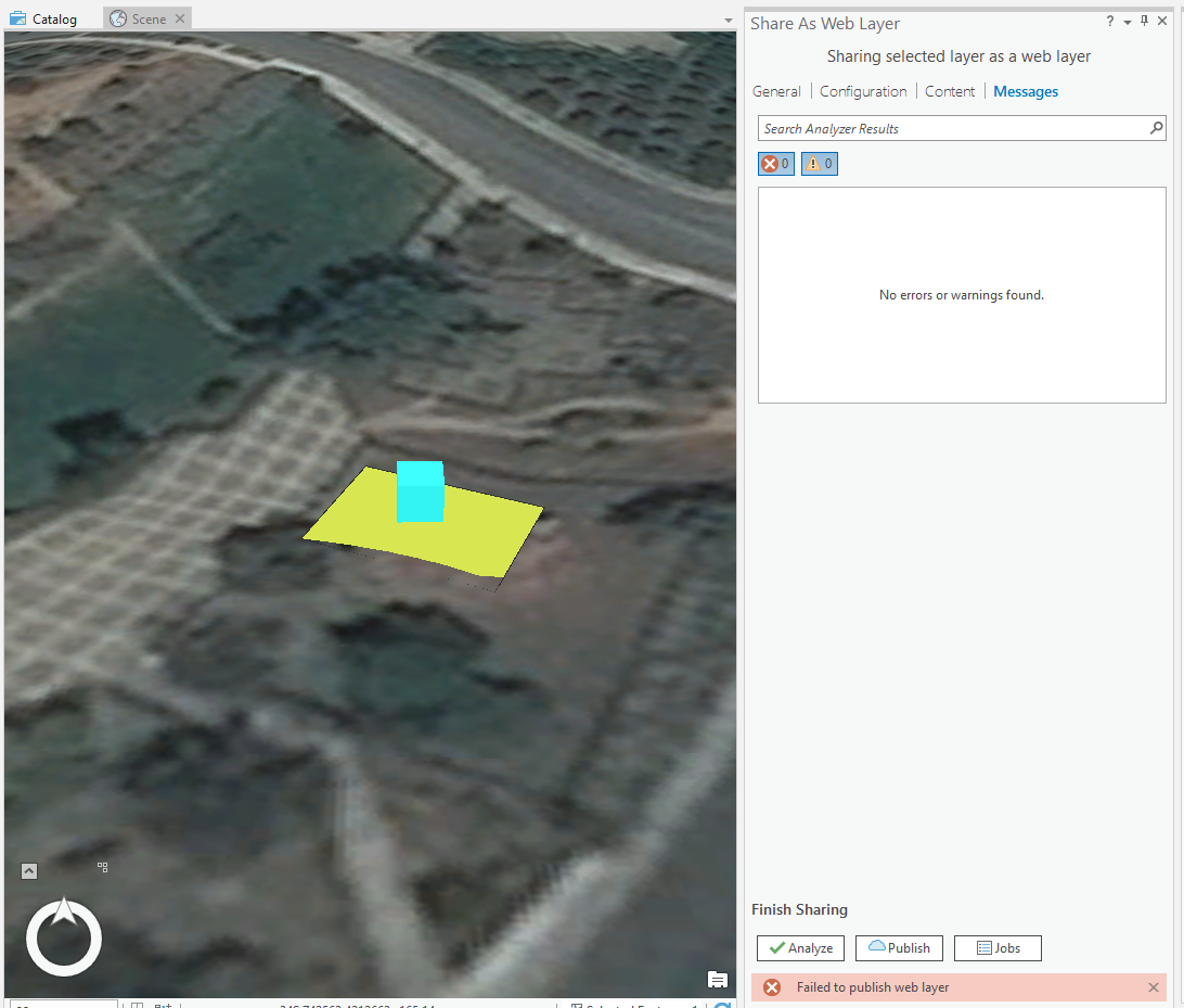

I am trying to share a multi patch feature as a web layer through ArcGIS Pro (trial version). I tried with a 2D polygon and it worked perfectly. When I analyze the "Share as Web Layer" job there are no errors but when I press "Publish" all I am getting is an empty uploaded web layer and this error "Failed to publish web layer" . I have already checked this post Failed to publish web layer without any luck. The scene is really basic and simple, that's why I find this issue really weird and frustrating. I look forward for any advice. Thank you very much in advance.
Trial and Developer accounts cannot publish hosted multipatch feature layers to ArcGIS Online.Only full organizational accounts can publish that geometry type for hosted feature layers.
Thank you very much for the info!
Hi @RussRoberts i am getting the same behaviour. it gives error to share as web scene and the error doesn't explain why. I'm using a premium developer account! aren't you supposed to be able to share multipach features?
