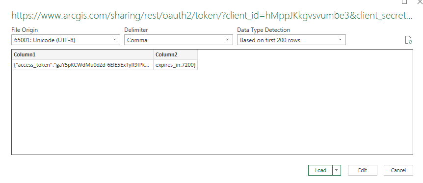

PART 2 Create your temporary token
1) To receive your token for your application replace CLIENTID and CLIENTSECRET with your own.
https://www.arcgis.com/sharing/rest/oauth2/token/?client_id=CLIENTID&client_secret=CLIENTSECRET&grant_type=client_credentials

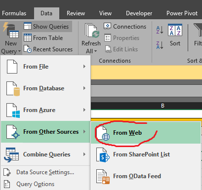

2) New query, from web and enter the url with your IDs.
3)choose advanced > ok
4) Choose EDIT

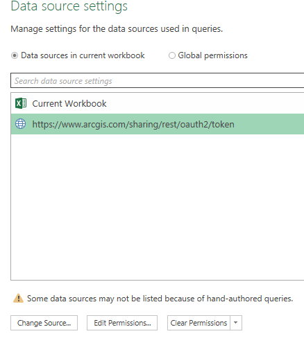

5) Select Data Source Settings
6) Change Source and select open file as JSON.
7) press advanced editor, we'll now edit the code so that it points to our tables. modify to code to
let//Custom Variablesaccess = Excel.CurrentWorkbook(){[Name="AGOL_ACCESS"]}[Content],client_id = access{0}[Value],client_secret = access{1}[Value],
Source = Json.Document(Web.Contents("https://www.arcgis.com/sharing/rest/oauth2/token/?client_id=" & client_id & " &client_secret="& client_secret & "&grant_type=client_credentials"), 65001),
#"Converted to Table" = Record.ToTable(Source)in #"Converted to Table"

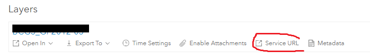

Next you'll need to get the service URL for your feature layer...

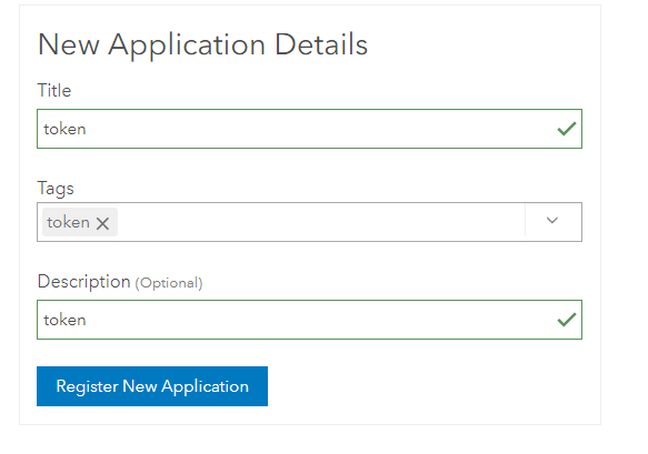

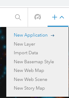

PART 1: CREATE TOKEN
d.Give your application a name, then click "Register"

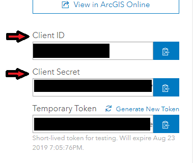

e. Note the Client ID and Client Secret

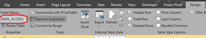

IN EXCEL: Insert three Tables
Enter the Client ID and Client Secret you just copied from the application you just created.
I like to name my tables;
From Top to bottom: AGOL_ACCESS, Token_auto, Hosted_FS0
