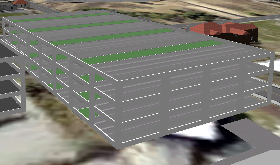

). I've come across two rules 1)Parking_Garage.cga (by Blake Harcourt) ("Garage"), which generates multiple stories with appropriate concrete facades, but is lacking the parking space generation I'm looking for. I'm attempting to combine this with Parking_Lot.cga (by geof7015)("Lot"), by copying all the attributes and rules into "Garage" which does a comp (f) for every story and sending the bottom face to what was the start rule for "Lot" and continuing through its process unchanged. The results range from every story having a blank white bottom face, to stretched linear splits that are supposed to be the parking spaces, streets, and medians, but all the wrong shapes (turns out its blank when the spaces are rotated 0, 90, 180, ect, but it attempts to actually make the splits when set to a rotation degree between). Does anyone know if splits act differently if the shape in question has been split earlier? It doesn't make sense to my limited programming knowledge.

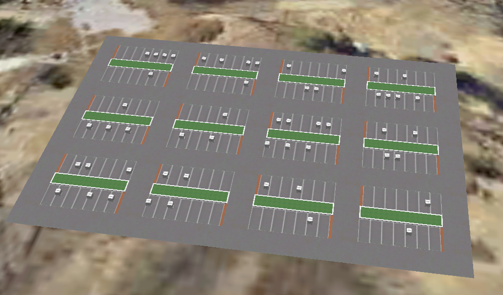

Here's the "Lot" rule in action:

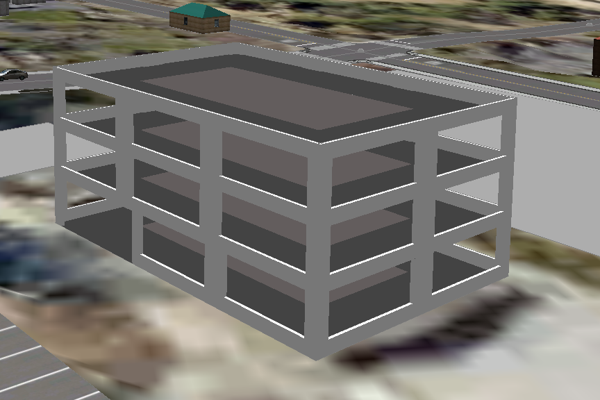

Here's the "Garage" Rule:
And here's them combined:
