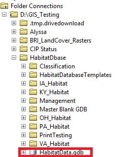

I've tried using the zipfile python library but am utterly confused on how to do it for a file geodatabase since it's not exactly a directory/file structure. My folder structure looks like so, I want to zip up the folder/geodatabase outlined in red:
