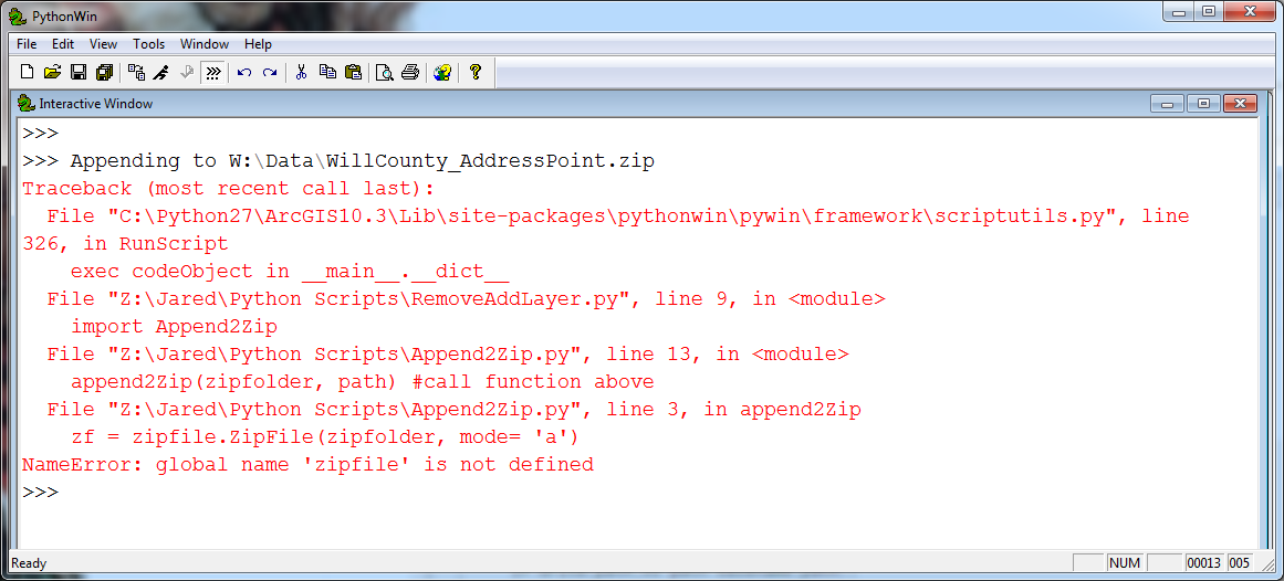

I have three consecutive scripts that 1) update features in a map, 2) zip them, then copy them to a new folder, 3) append a .txt file to the zip. But, I can't quite grasp how to run all of them in order. I ran RemoveAddLayer.py assuming I was calling the other two scripts correctly. There was an error(s) (see very bottom).

<SPAN class="comment token">###Append2Zip.py</SPAN>
<SPAN class="keyword token">def</SPAN> <SPAN class="token function">append2Zip</SPAN><SPAN class="punctuation token">(</SPAN>zipfolder<SPAN class="punctuation token">,</SPAN> path<SPAN class="punctuation token">)</SPAN><SPAN class="punctuation token">:</SPAN> <SPAN class="comment token"># define function; name of function followed by any arguments in ()</SPAN>
<SPAN class="keyword token">print</SPAN> <SPAN class="string token">'Appending to '</SPAN> <SPAN class="operator token">+</SPAN> zipfolder
zf <SPAN class="operator token">=</SPAN> zipfile<SPAN class="punctuation token">.</SPAN>ZipFile<SPAN class="punctuation token">(</SPAN>zipfolder<SPAN class="punctuation token">,</SPAN> mode<SPAN class="operator token">=</SPAN> <SPAN class="string token">'a'</SPAN><SPAN class="punctuation token">)</SPAN>
<SPAN class="keyword token">try</SPAN><SPAN class="punctuation token">:</SPAN>
zf<SPAN class="punctuation token">.</SPAN>write<SPAN class="punctuation token">(</SPAN>path<SPAN class="punctuation token">,</SPAN> os<SPAN class="punctuation token">.</SPAN>path<SPAN class="punctuation token">.</SPAN>basename<SPAN class="punctuation token">(</SPAN>path<SPAN class="punctuation token">)</SPAN><SPAN class="punctuation token">)</SPAN>
<SPAN class="keyword token">finally</SPAN><SPAN class="punctuation token">:</SPAN>
zf<SPAN class="punctuation token">.</SPAN>close<SPAN class="punctuation token">(</SPAN><SPAN class="punctuation token">)</SPAN>
path <SPAN class="operator token">=</SPAN> r<SPAN class="string token">'Z:\Jared\Disclaimer - Final.txt'</SPAN>
zipfolders <SPAN class="operator token">=</SPAN> <SPAN class="punctuation token">[</SPAN>r<SPAN class="string token">'W:\Data\WillCounty_AddressPoint.zip'</SPAN><SPAN class="punctuation token">,</SPAN> r<SPAN class="string token">'W:\Data\WillCounty_Street.zip'</SPAN><SPAN class="punctuation token">]</SPAN> <SPAN class="comment token">#list of zip folders</SPAN>
<SPAN class="keyword token">for</SPAN> zipfolder <SPAN class="keyword token">in</SPAN> zipfolders<SPAN class="punctuation token">:</SPAN> <SPAN class="comment token"># loop through zipfolders</SPAN>
append2Zip<SPAN class="punctuation token">(</SPAN>zipfolder<SPAN class="punctuation token">,</SPAN> path<SPAN class="punctuation token">)</SPAN> <SPAN class="comment token">#call function above</SPAN><SPAN class="line-numbers-rows"><SPAN></SPAN><SPAN></SPAN><SPAN></SPAN><SPAN></SPAN><SPAN></SPAN><SPAN></SPAN><SPAN></SPAN><SPAN></SPAN><SPAN></SPAN><SPAN></SPAN><SPAN></SPAN><SPAN></SPAN><SPAN></SPAN><SPAN></SPAN><SPAN></SPAN></SPAN>
