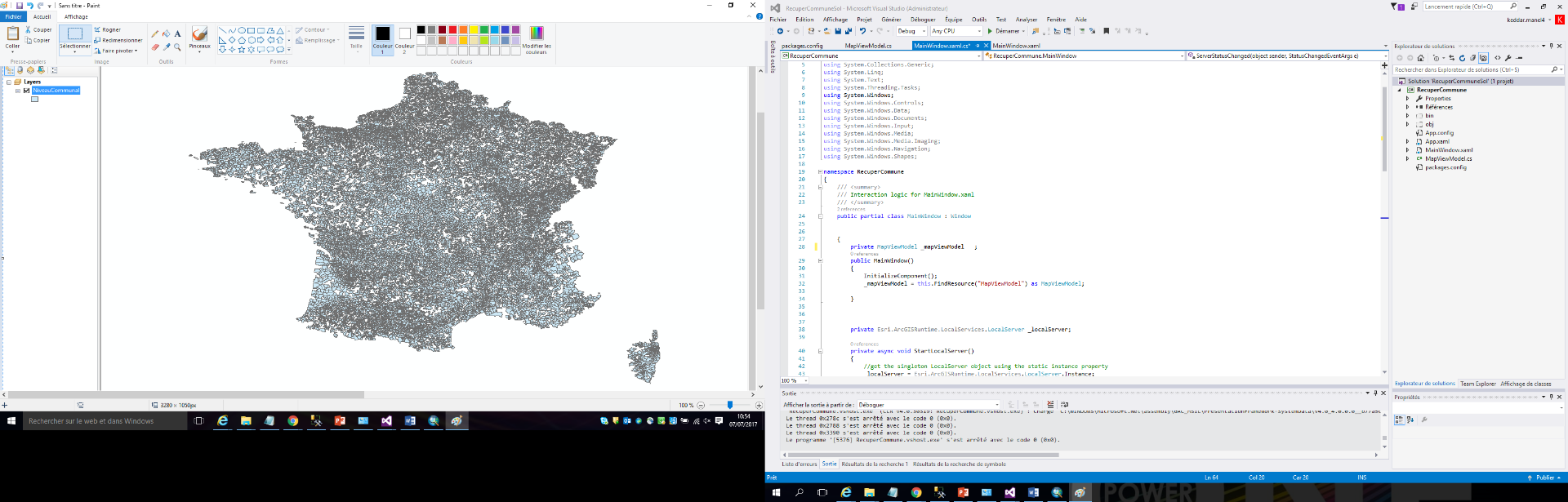

And my code doesn't do any thing , actually i have to display the France departements as layers , i have joind a picture of my layers that is supposed to be displayed
but my code doesn't show any thing
please help me
