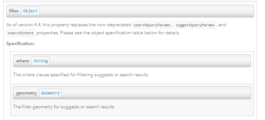

I am using the search widget to enable me to text search the layer, where I have connected my layer of points. In this search widget, I can filter on a where statement, or geometry.
I have been able to successfully use the where statement when searching for objects within the same layer, but have not been able to get the filter by geometry to work. Here is a snippet of what I have come up with so far. In the console, it is showing that I am returning geometry objects, and it doesn't throw an error when I try to set the searchWidget geometry to the response geometry. However, it still returns points outside of my city boundary.
