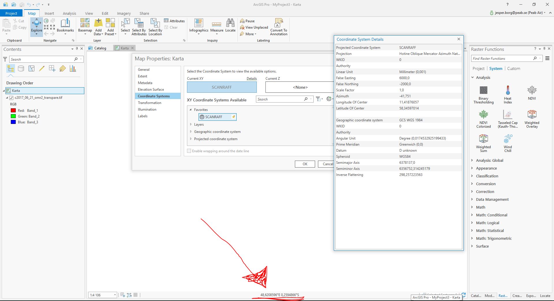

I'm trying to transform coordinates on my raster file. I think I have succesfull done the raster conversion. But the base map is still in WGS 84 and I can't see the raster file anywere. I have tried to change the coordinat system on the properties for the map. I have tried to delete the base map but I still can't see the raster file.
Center of the raster file is suppose to be:
34.21000000000.00000000000.0000000000-34.2100000000-690861.5803218026603704.2691675390
Or maybe I haven't even made the tranfsormation...
I tried to choose my system, scanraf but I when I choose it on the spacial reference box and klick OK, it dosen't appere an spacial reference to the right.
your prj is
PROJCS["SCANRAFF",GEOGCS["WGS 84",DATUM["unknown",SPHEROID["WGS84",6378137,298.257223563]],PRIMEM["Greenwich",0],UNIT["degree",0.0174532925199433]],PROJECTION["Hotine_Oblique_Mercator_Azimuth_Center"],PARAMETER["Latitude_Of_Center",58.34597014],PARAMETER["Longitude_Of_Center",11.41876057],PARAMETER["Azimuth",-41.751],PARAMETER["Rectified_Grid_Angle",0.0],PARAMETER["Scale_Factor",1],PARAMETER["False_Easting",6000],PARAMETER["False_Northing",-2000],UNIT["Millimeter",0.001]]
Hotine_Oblique_Mercator_Azimuth_Center"]Hotine_Oblique_Mercator_Azimuth_Center"]
perhaps? The header suggests projected values
but I dont know if they are for that one
I tried to change it to Azimuth Center but no resaults so far 😕
I tried to do a new prj fil from the old one:
PROJCS["PreemRaff_1",GEOGCS["GCS WGS 1984",DATUM["D_WGS_1984",SPHEROID["WGS_1984",6378137.0,298.257223563]],PRIMEM["Greenwich",0.0],UNIT["Degree",0.0174532925199433]],PROJECTION["Hotine_Oblique_Mercator_Azimuth_Center"],PARAMETER["False_Easting",6000.0],PARAMETER["False_Northing",-2000.0],PARAMETER["Scale_Factor",1.0],PARAMETER["Azimuth",-41.751],PARAMETER["Longitude_Of_Center",11.41876057],PARAMETER["Latitude_Of_Center",58.34597014],UNIT["Millimeter",0.001]]<SPAN class="line-numbers-rows"><SPAN></SPAN></SPAN>
But no success there either...
I'm not sure that I'm doning the transformation right...
What's the best way to change coordinates? To Export raster or Reprojection?
in order to do anything useful with the file it needs to be defined correctly first using the Define Projection tool in arctoolbox
