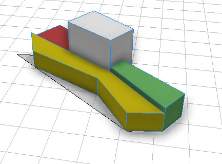

I'm splitting up a base dae shape into it's component faces (4 in this case) and extruding these to random heights.
Each of these in turn simply report back the scope elevation, in this case... 7,19,5,9.
When I then run the code above, per each extrusion, the float simply get's set to 7, then 19, then 5 then 9?
