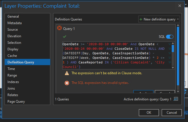

I've noticed that some queries seem to be too complex within the SQL Expression Editor; previously I had issues running a calculation from a datefield that would not work on anything less than 6 months. Here's an example that I'm running into today:
I have a map that needs to be updated bi-weekly, it's based on the following query:
2 week range >= and >
a diff that calculates one business day turnaround
according to two complaint flags
OpenDate <SPAN class="operator token">>=</SPAN> <SPAN class="string token">'2020-07-27 00:00:00'</SPAN> <SPAN class="operator token">And</SPAN> OpenDate <SPAN class="operator token"><</SPAN> <SPAN class="string token">'2020-08-10 00:00:00'</SPAN>
<SPAN class="operator token">AND</SPAN> <SPAN class="punctuation token">(</SPAN>DATEDIFF<SPAN class="punctuation token">(</SPAN>Day<SPAN class="punctuation token">,</SPAN> OpenDate<SPAN class="punctuation token">,</SPAN> CaseInspectionDate<SPAN class="punctuation token">)</SPAN> <SPAN class="operator token">-</SPAN> DATEDIFF<SPAN class="punctuation token">(</SPAN>Week<SPAN class="punctuation token">,</SPAN> OpenDate<SPAN class="punctuation token">,</SPAN> CaseInspectionDate<SPAN class="punctuation token">)</SPAN> <SPAN class="operator token">*</SPAN> <SPAN class="number token">2</SPAN> <SPAN class="operator token"><=</SPAN> <SPAN class="number token">1</SPAN> <SPAN class="punctuation token">)</SPAN>
<SPAN class="operator token">AND</SPAN> CaseReported <SPAN class="operator token">IN</SPAN> <SPAN class="punctuation token">(</SPAN><SPAN class="string token">'Citizen Complaint'</SPAN><SPAN class="punctuation token">,</SPAN> <SPAN class="string token">'City Council'</SPAN><SPAN class="punctuation token">)</SPAN><SPAN class="line-numbers-rows"><SPAN></SPAN><SPAN></SPAN><SPAN></SPAN></SPAN>
Then when I go to make a simple edit, changing the string for date:
OpenDate <SPAN class="operator token">>=</SPAN> <SPAN class="string token">'2020-08-10 00:00:00'</SPAN> <SPAN class="operator token">And</SPAN> OpenDate <SPAN class="operator token"><</SPAN> <SPAN class="string token">'2020-08-24 00:00:00'</SPAN>
It flips out like so:
Pretty horrible right?
Is this a bug?

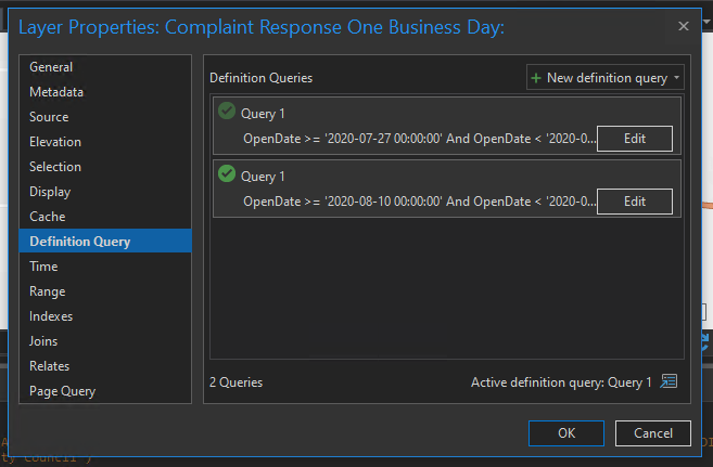

aprx<SPAN class="punctuation token">.</SPAN>save<SPAN class="punctuation token">(</SPAN><SPAN class="punctuation token">)</SPAN><SPAN class="line-numbers-rows"><SPAN></SPAN><SPAN></SPAN><SPAN></SPAN><SPAN></SPAN><SPAN></SPAN><SPAN></SPAN><SPAN></SPAN><SPAN></SPAN><SPAN></SPAN><SPAN></SPAN><SPAN></SPAN><SPAN></SPAN><SPAN></SPAN><SPAN></SPAN><SPAN></SPAN><SPAN></SPAN><SPAN></SPAN><SPAN></SPAN><SPAN></SPAN><SPAN></SPAN><SPAN></SPAN><SPAN></SPAN><SPAN></SPAN><SPAN></SPAN><SPAN></SPAN><SPAN></SPAN></SPAN>Which at first blush, also did nothing.
I ran this several times with no resulting changes in the map.
I restarted the program and still nothing.
Then, I left the program closed for more than 10 minutes, and when I get back, I have these results:

- If I'm changing the value on lyr.definitionQuery, then I'd think it would be an over-write and not an append? and if lyr.definitionQuery is a read/write; how does one access multiple queries to appropriately delete/add what they need?
- Why are these values not showing up immediately within the project? and why do I need a long cold restart to view changes made with ArcPy?
- this is an issue that I've seen before of needing to close a project for a ArcPy-derived result to appear in previous Pro versions
- What's with the GUI not accepting changes to complex queries, or refusing to write them in the first place?
