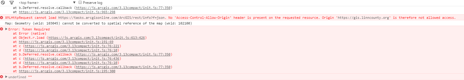

First, If I just change the web map id to the map published on our server in the config.js file on our server and I don't change any of the basemap settings I can get the app to partially work but if I look and the js console on chrome the app gets the following error:
Also, when I go to change basemaps the app locks up.

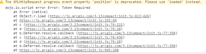

When I search by Activity it throws another error which looks like it is related to the first:
