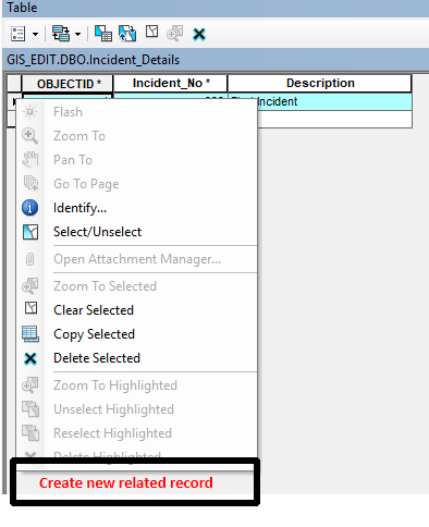

Suppose the Incident_Details (non spatial Table) has just one record with Attributes: Incident_No = 999, Description = First incident
I want to now be able to open both the Incident_Details table and Incident_Point within ArcMap and Create a new point that has a relationship with the Incident_Details record where Incident_No = 999. I do not want to do this by manually entering Foreign Key Incident_No = 999 for the newly created point.
I want to be able to start with the record within ArcMap in the Incident_Details table, click it and 'Create new related record'. IE via a right click within the attribute table and 'Create new related record':
- This process is being designed for a non-technical user who does not have the skills to accurately relate the records my manually entering the relationship dependent Incident_No
- Ideally the data will be published as a feature service (non-hosted) and the user will create the related point in an AGOL web map (so hoping AGOL might have this ability as well as ArcMap as I note above)
