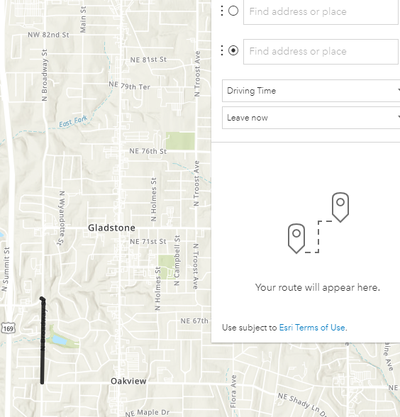

Just noticed a small bug with JS API 4.17 (but also in previous version): when a direction is highlited after having clicked on it in the widget, it is not cleaned up after reseting the route or destroying the widget:
You can easily reproduce it on this sample:

Hi Nicolas GIS, thank you for reporting this issue. I can reproduce it as well. Will investigate and update this thread when we have an update to share.
As a follow-up, if you use the `Clear route` option, does it properly clear the route and segments properly?
