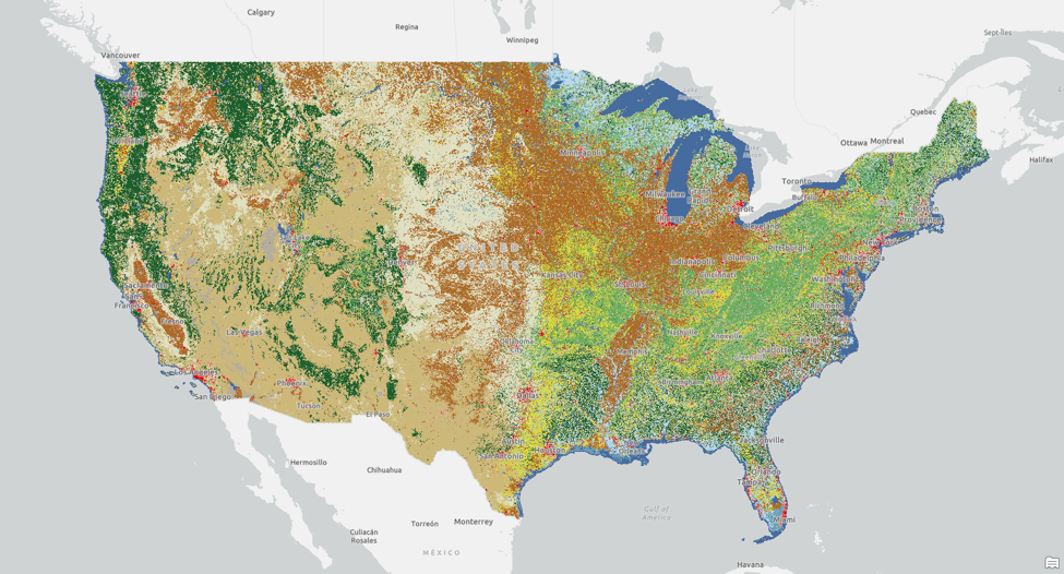

Each of the datasets provides a land cover value for every 30-meter cell across the conterminous United States. As an example, let’s take a look at the 2020 data:

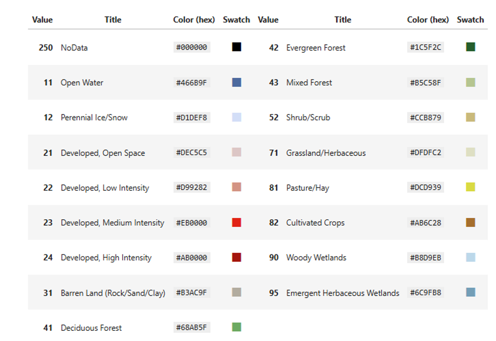

The land use classes are divided into the following categories:

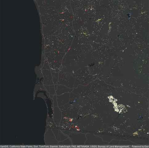

luc_change = composite.select(RT.select_bands(RT.apply("composite_raster", 2, change_lambda), [2]).alias("change"))This gives us a new calculated raster with the land use change. We can zoom in to see how this looks for an area near San Diego, California – the individual raster cells with changes in land use between the two years are shown:

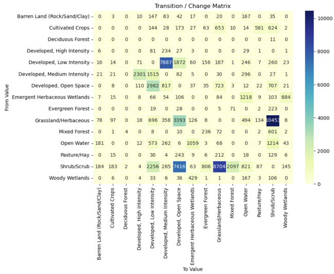

We could also process the data further to look at the change as a matrix to see how the land use classes have changed across years:

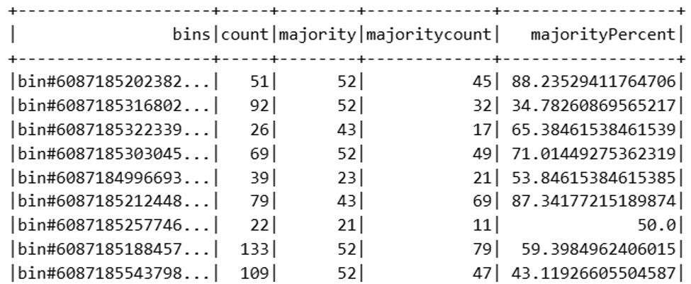

.run(luc_change)Now, for each of our hexagonal bins we know the details on all of the cells changing value in that zone – the count, majority and minority class, percent covered by that class, etc.

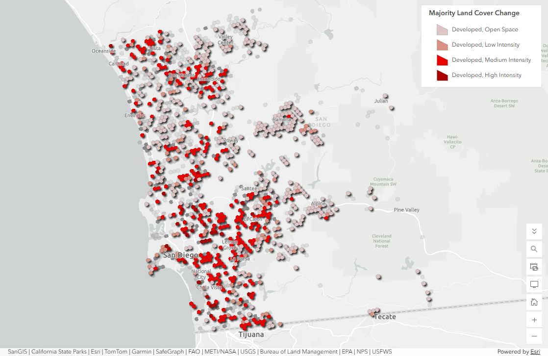

Often, you don’t need all transitions, you care about specific ones. For example, exploring all of the changes into a “Developed” land use class. Note that these could be changes from undeveloped to developed or between intensities of development. We can explore these patterns with a filter to focus the view on just the regions where the majority change is to become a Developed land use class and where the change percent is greater than 50%.
Now we can more easily see the regions where the development is focused, and where the intensity of development is increasing the most.
