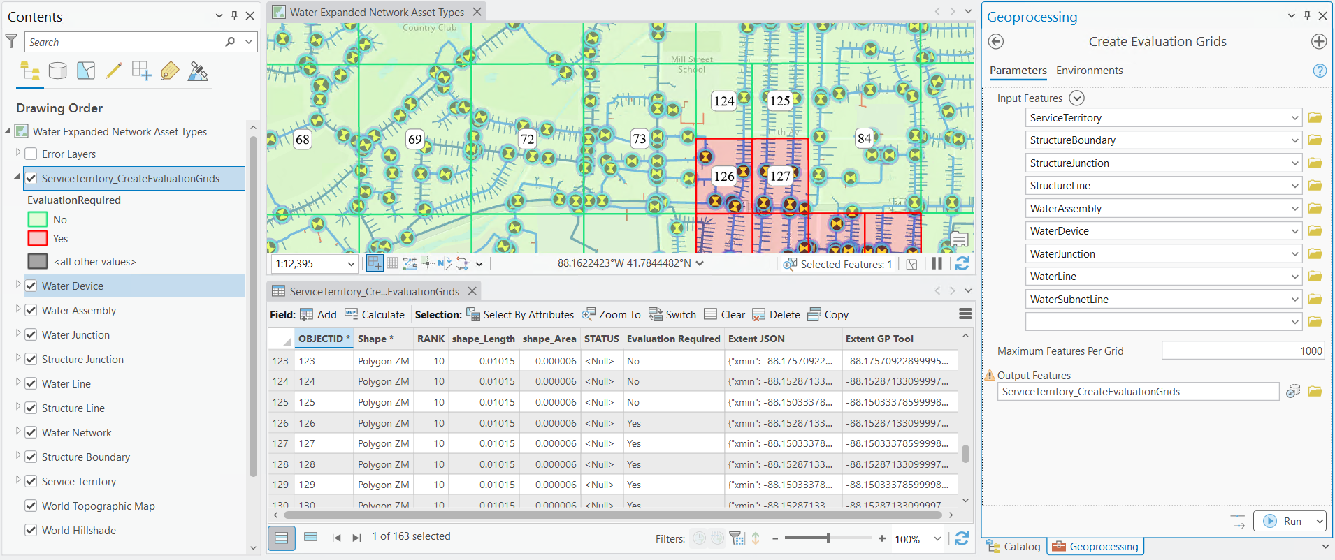

To create these extents, the tool leverages the Create Cartographic Partitions geoprocessing tool. This tool creates output polygons based on the density and distribution of features, allowing the evaluation workload to be divided into more manageable areas.
The Maximum Features Per Grid parameter is used to establish an upper limit for the number of features that can be included within a given evaluation extent. One or more feature classes can be specified as inputs, and the total feature count across all selected feature classes is used when determining the partition boundaries. As a result, areas with higher feature density produce smaller grid polygons, while less dense areas produce larger grid polygons.

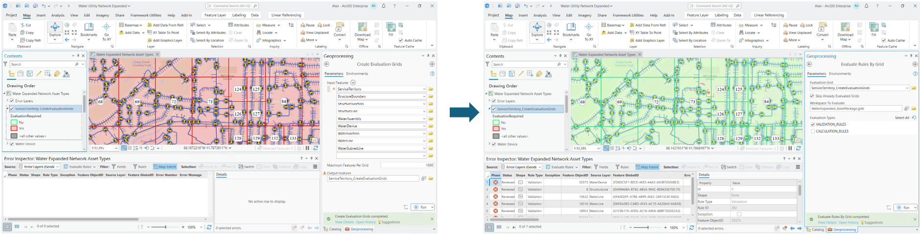

When the tool completes, it adds an Evaluation Required field and extent information fields to the generated partitions, applies symbology, and adds the resulting layer to the active map.

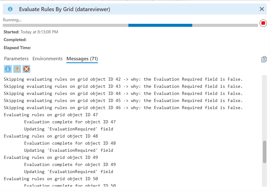

As the tool runs, a geoprocessing message is added after each polygon grid is evaluated, indicating whether the grid was processed or skipped. This makes it easier to track progress during long-running evaluations.

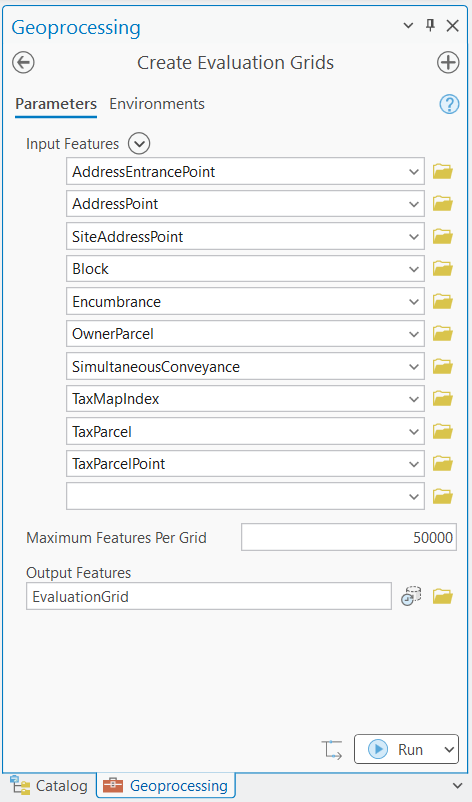

- For Input Features, select the feature layers that contain validation attribute rules
- Set the Maximum Features Per Grid parameter
- Set the output location
- Outputs can be placed in file, mobile, or enterprise geodatabases.
- The output will be in WGS 1984, so if placing the output in a feature dataset, it must be in WGS 1984.
- Run the tool

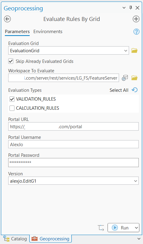

- Open the tool and for Evaluation Grid, select the grid output from the Create Evaluation Grids run
- Keep Skip Already Evaluated Grids checked
- For Workspace to Evaluate, select the file, mobile, or feature service to evaluate attribute rules on
- If the workspace is a feature service URL, additional parameters will appear
- Fill out the Portal URL, Portal Username, and Portal Password for the enterprise user that will be running the evaluation.
- Specify the version to run evaluation on.
- Please note that this field will automatically be populated with a dropdown list of available versions once the portal information is specified. This may take a minute.
- Set the Evaluation Type
- Run the tool
- While the tool is running you can view the messages. This will tell you which grid polygons have been evaluated and which were skipped (if any).
