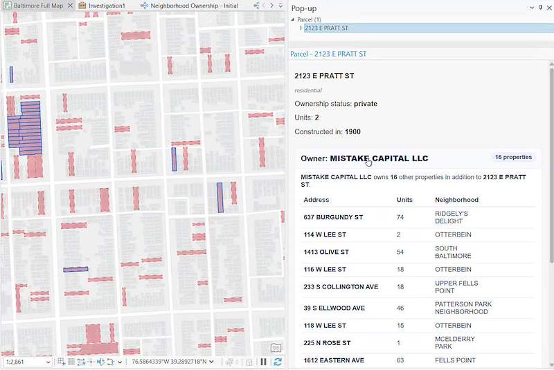

After the query returns results, format them for the pop-up. Most expressions:
- Build a dictionary with named sections or formatted output.
- Format results as text, lists, small tables, or links.
- Return one structured object that the ArcGIS pop-up engine can render.
This is where raw graph results become readable context for the selected map feature, entity, or link-chart element.

Format ArcGIS Knowledge Graph Query Results in Pop-ups
Arcade expressions can format graph query results in several pop-up-friendly ways. Common patterns include:
- Generate sections with expandable lists or tables of resulting related entities matching your pattern
- Generate tables of resulting entities and statistics created using the query
- Generate dynamic links to entities (starting in 11.4) or saved queries (starting in 12.0) in the Knowledge Studio web app using URL Parameters.
