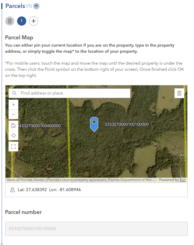

In the survey that I'm building, I want to extract parcel number(s) from a layer using a map. The surveyed will be using a map to point at the aerial view and calculate that value into a field (Web designer essentials—ArcGIS Survey123 | Documentation). Seeing that participants will most likely have more than one parcel number, I went to see if this action can be repeated within the survey using Repeats (What’s New in ArcGIS Survey123 (March 2026)), thus creating a one-to-many relationship table. When testing, it works in the survey, but it does not save the values. I know the data calculation works on its own, but I need the related table. If there any way I can achieve my goal or any fixes to my procedure, please let me know.
