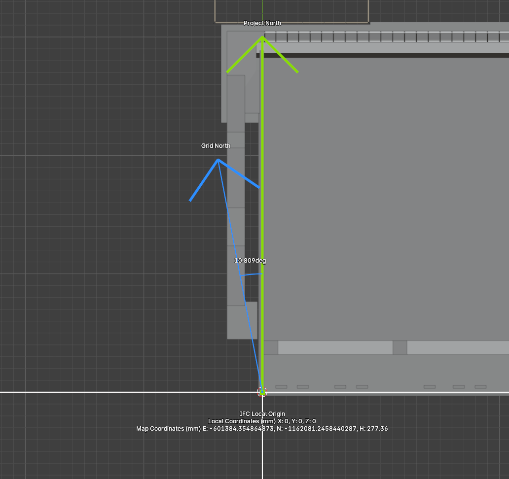

ukázka modelu s rotací nastavenou v IfcMapConversion:
29=IFCPROJECTEDCRS('EPSG:5514','Krovak East North',$,$,$,$,$);
#30=IFCMAPCONVERSION(#24,#29,-601384.35486487299,-1162081.2458440287,277.36000000000001,0.98225816853758341,-0.18753370454718901,0.001);

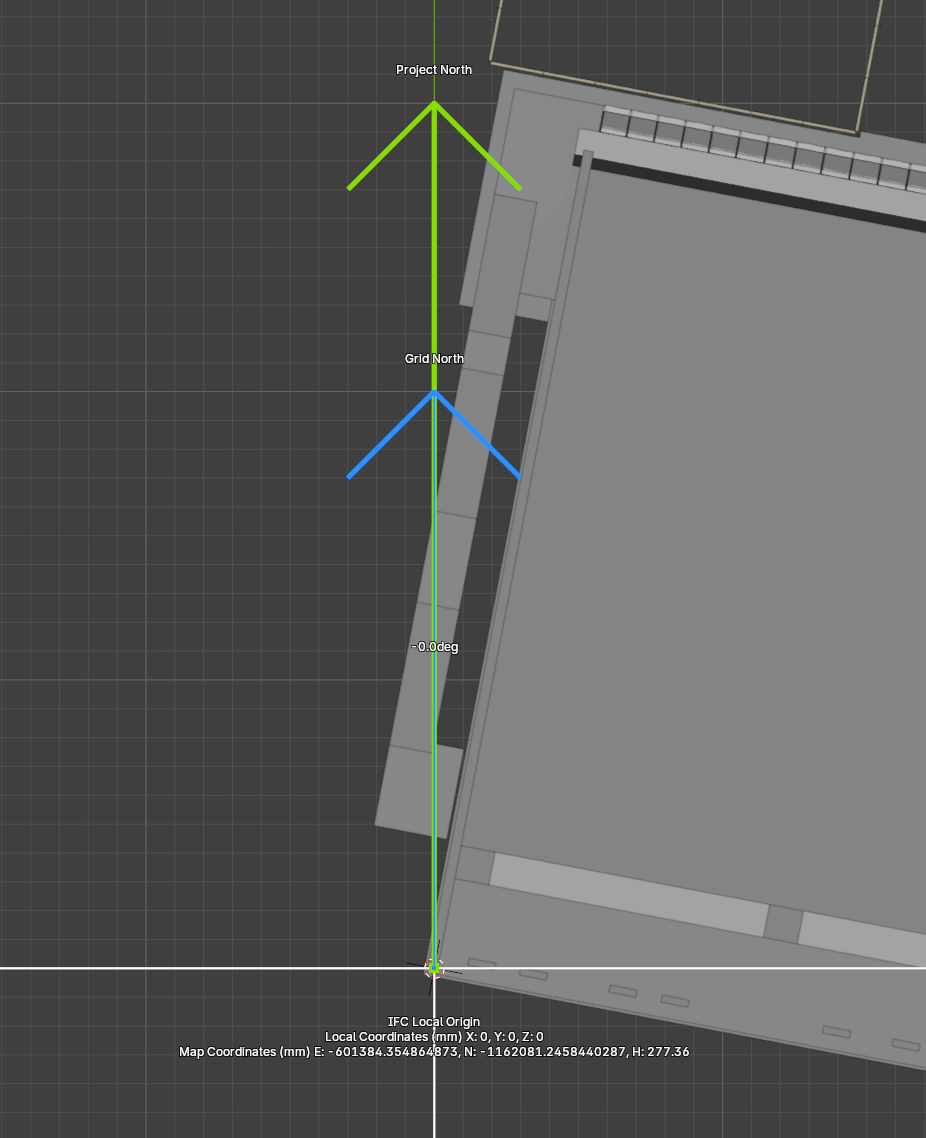

ukázka modelu s rotací nastavenou přímo v datech:
#30=IFCMAPCONVERSION(#24,#29,-601384.35486487299,-1162081.2458440287,277.36000000000001,1.,6.123233995736766E-017,0.001)
