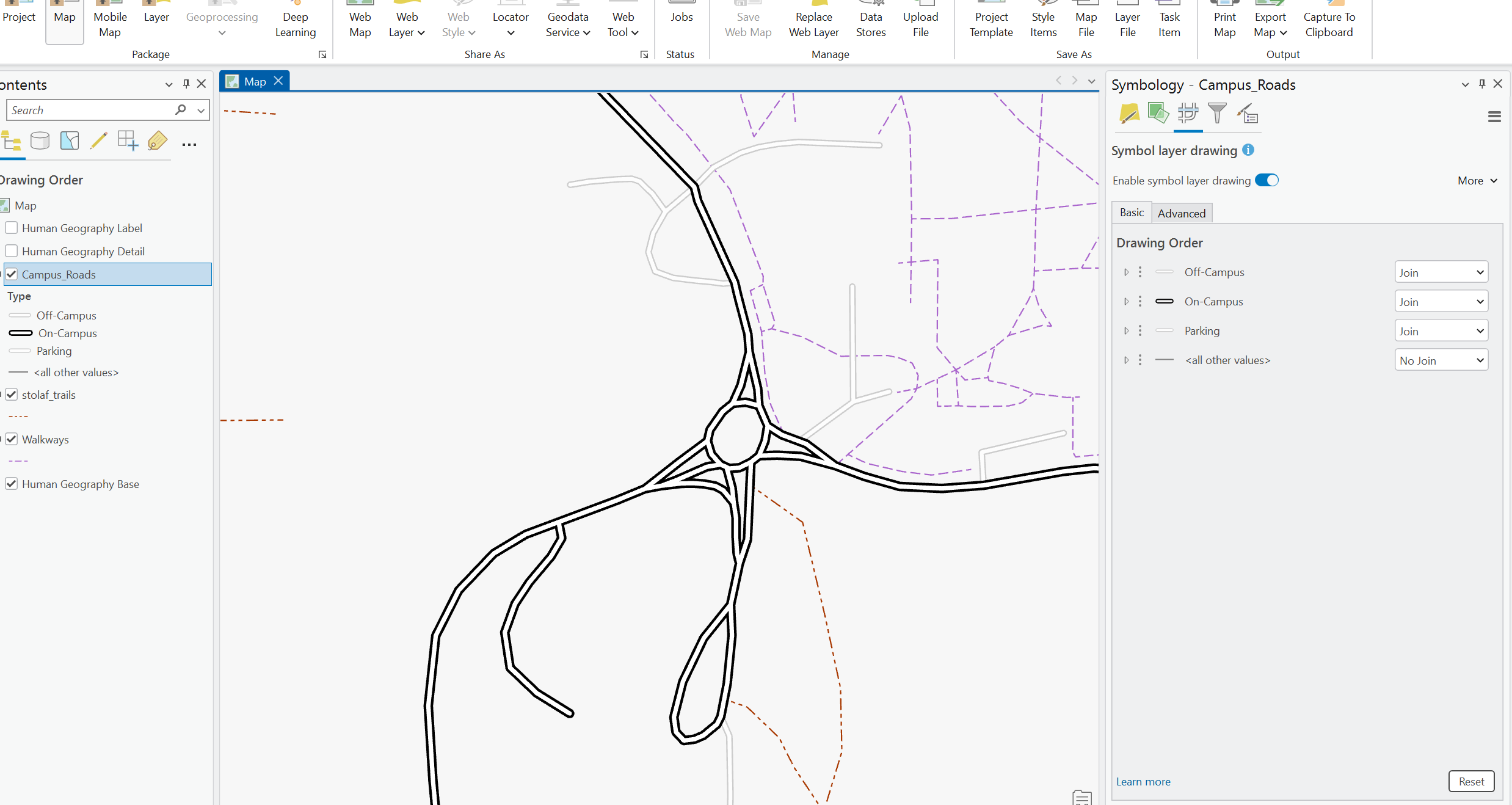

I published some road data from ArcGIS Pro to ArcGIS Online (Shared as a Web Map) - in this map, I have the "Enable Symbol Layer Drawing" turned on so the roads look like one feature

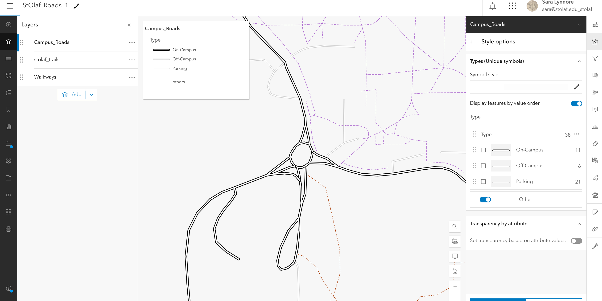

When I view the map in ArcGIS Online - it looks like the setting is not carried over:
Does anyone know if there is a similar setting in ArcGIS Online? I tried to add the road as a separate shapefile as well, and it still shows up as separate features.
Alternatively - I'm thinking I can duplicate the feature and make it merged into one road, and overlay that on top to create the effect, but I'm just curious if there is a setting I can use first before I do that.
