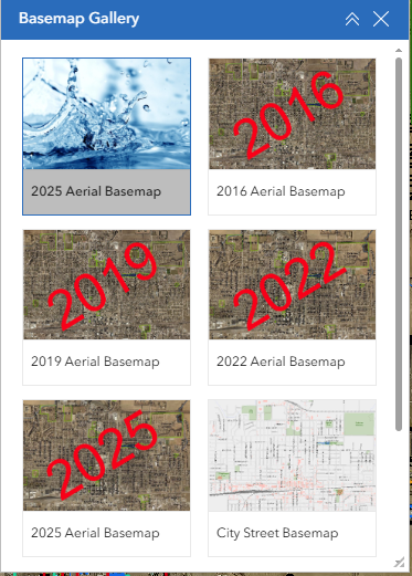

The problem I have is if I have Synchronize with the Basemap Gallery setting of your organization. Then I have the same basemap twice. For example if I have my map set to my 2025 aerials it shows that as the first selection in the Widget. But my 2025 Aerials is also in my Basemap Gallery. So now that basemap is listed twice. In addition the first listing which is the Maps default Basemap shows just a small display of the map and not the actual Basemap Thumbnail that was set for it.
The workaround I have found is I could set the Widget settings to configure Custom Basemaps and only choose the ones out of my Gallery, except for the default Basemap of the Map so there is not two listed. Then to fix the thumbnail issue is a set the Thumbnail of the Web Map to the same as the Basemap.

Picture of how I have mine set up with an appropriate Thumbnail for the Webmap for my Field Maps User but still showing a duplicate in the Experience Builder Widget. Again Not Ideal.
