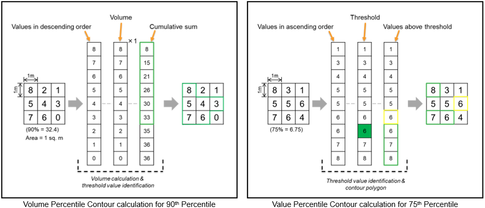

On the other hand, Volume Percentile Contours outline the smallest area that contains the specified share of the whole. They show where most of the phenomenon resides— a compact core for strategy. Behind the scenes, the tool ranks cells from high to low and accumulates volume (value × cell area, with Planar or Geodesic method available for area calculation) until the target share is reached, then draws the boundary at that threshold. To simply express, Value is the extent of highs and Volume is the core of the whole.
Figure 1: Delineating contour area for Volume Percentile Contours (left) and Value Percentile Contours (right)

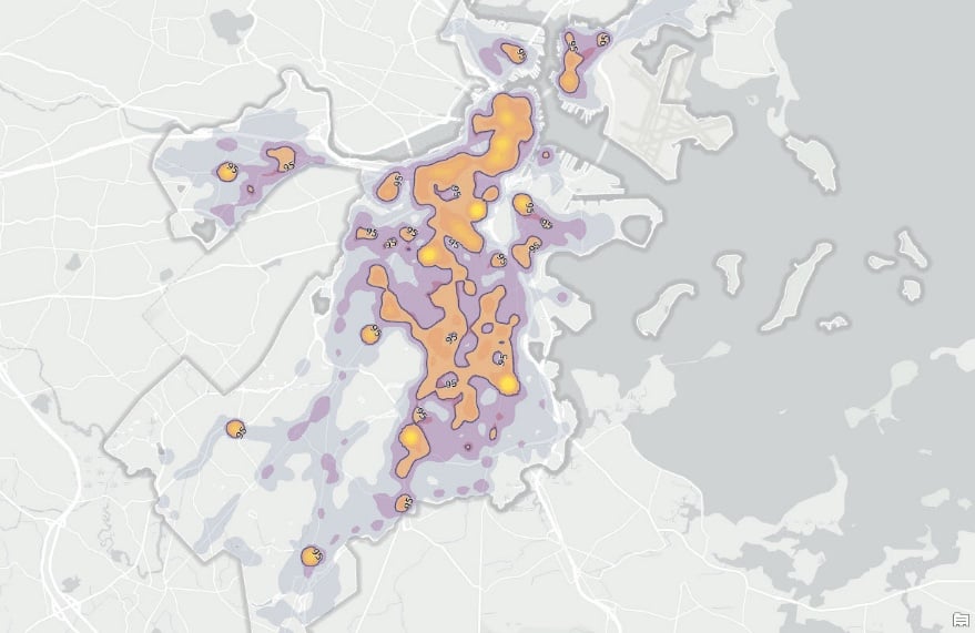

We’ve converted reported crime incidents (2015–2024) into a continuous surface using Kernel Density. First is to identify the strategic core with Volume Percentile Contour. For that we can use the 50th percentile values as the threshold. The tool ranks the highest cells first and accumulates until half of the overall amount is captured. The result is the smallest area holding half of the problem. This is where broad, sustained actions pay off without spreading thin.
Figure 2: 50th Percentile volume contour extracted from crime events density raster

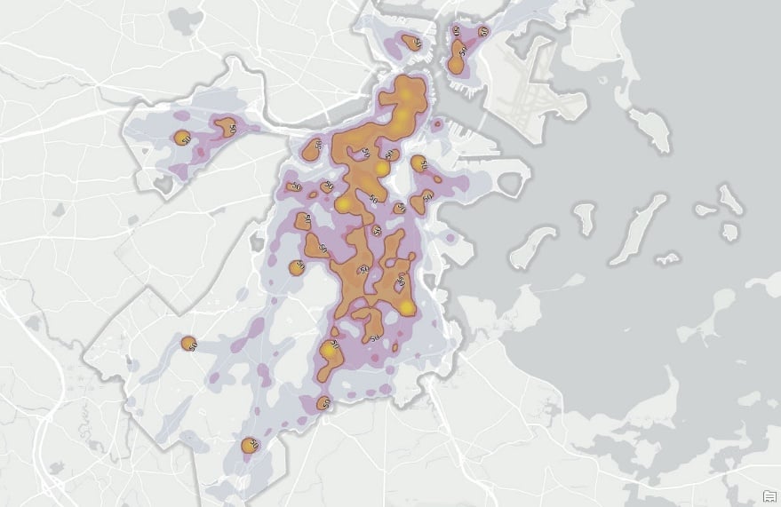

While the output is useful for long-term planning, what about the spots that need immediate attention? For that, we will use the Value Percentile Contours tool. With the same Density raster, now we will set the percentile value to 95%. The output value percentile contour shows all locations where the density is in the top 5% - places most likely to need immediate attention: patrols, site checks, quick fixes.
Figure 3: 95th Percentile value contour extracted from crime events density raster

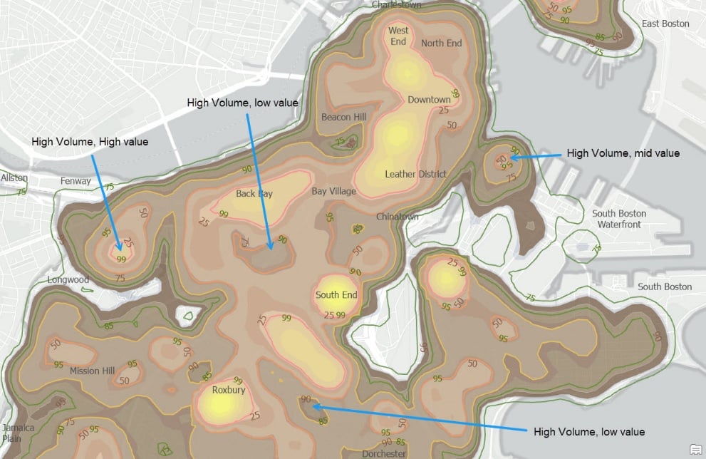

Now we can use outputs from both these tools and generate actionable intelligence. For example, if you see a place with Value 95 and Volume 25, that location is both very high and captured early in the accumulation—hot and central. In contrast, if you see Value 90 | Volume 75, it’s still high but more peripheral—better for monitoring and targeted follow-ups than heavy deployment.
Figure 4: Volume and Value Percentile contours together enable users to avoid blind spots in short-term and long-term planning
