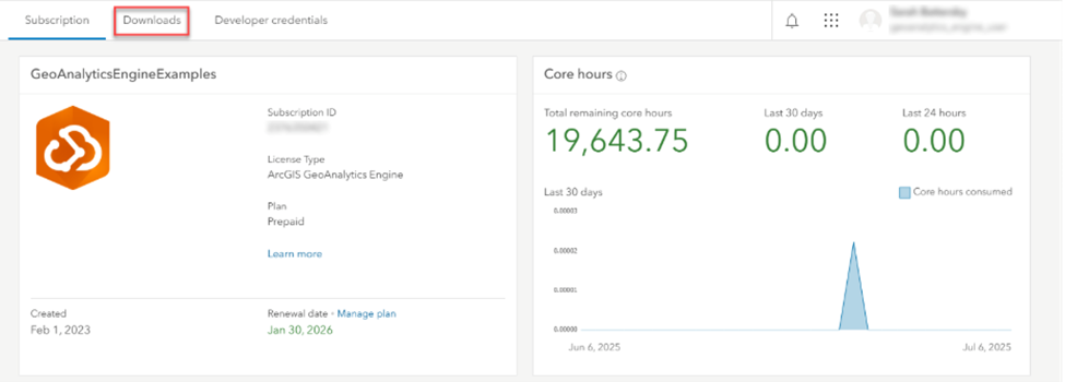

If you are working with a GeoAnalytics Engine Connected license, you will download the relevant files via the GeoAnalytics Engine dashboard.
Log into the dashboard with your user credentials for GeoAnalytics Engine. Note that these are different than your ArcGIS Online user credentials.
From the dashboard, click on the Downloads tab.

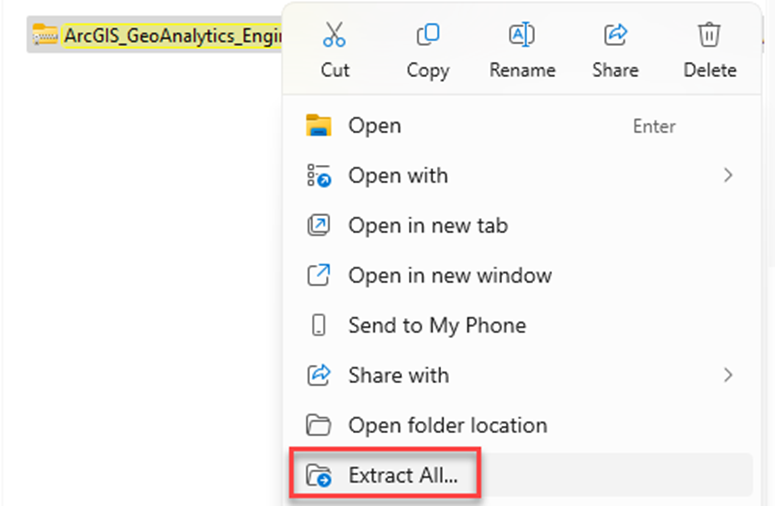

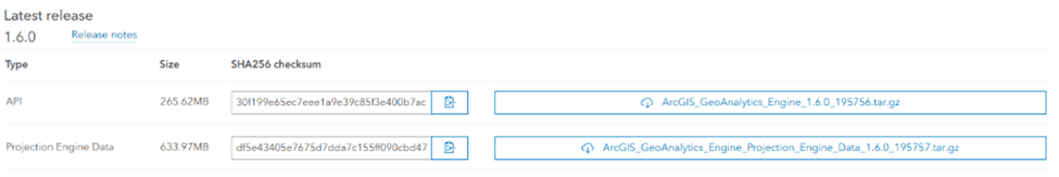

From the Downloads tab, you will have access to the latest releases. There are two files – both are tar.gz files and you will need to extract the files from the *.tar.gz file. You may be able to simply right click on the downloaded file and select “Extract All…” to extract the GeoAnalytics Engine files.
- Projection Engine Data (optional) – an optional set of data for the Projection Engine. If you are working with map projections or coordinate systems that aren’t included in the basic set in GeoAnalytics Engine, you will want these additional files to facilitate coordinate system transformations. More information about the projection engine can be found in the help documentation on coordinate systems and transformations

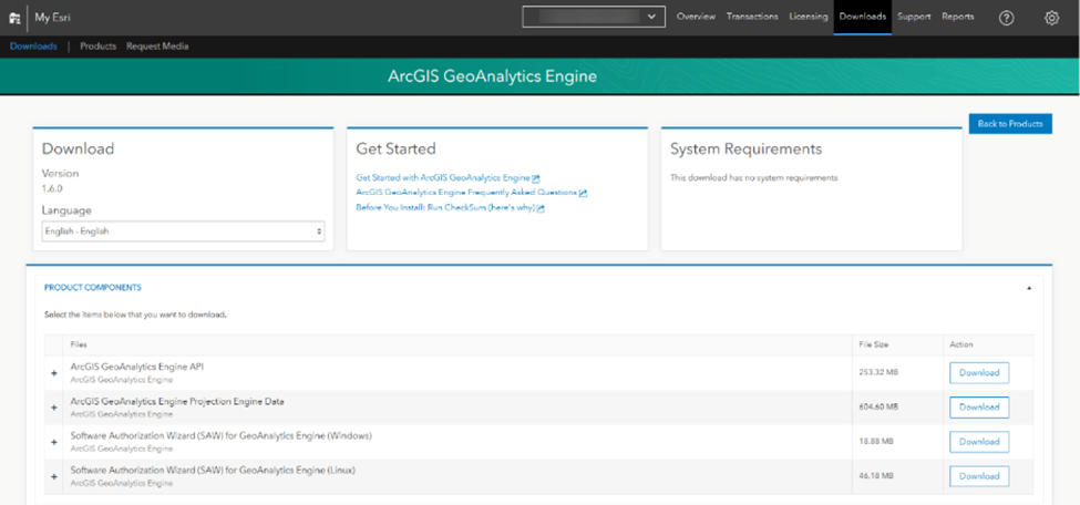

For a disconnected license, you will access the files for GeoAnalytics Engine using My Esri. From the My Esri home page, click on the Downloads tab and choose "All Products and Versions". Under "All Other Products" find ArcGIS GeoAnalytics Engine and click the "View Downloads" button. There are four downloads available for the latest release.
- Software Authorization Wizard (SAW) for GeoAnalytics Engine (Microsoft Windows) – A Windows application for activating your disconnected license.
- Software Authorization Wizard (SAW) for GeoAnalytics Engine (Linux) – A Linux application for activating your disconnected license.

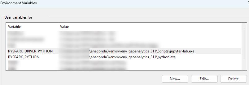

Because I occasionally switch between Spark versions, and don’t want all of my settings permanently in my Path, I have opted to set most of my environment variable (related to Java, Spark, and Hadoop) as part of a startup script. However, there are two items that I do add to my Path: PYSPARK_PYTHON and PYSPARK_DRIVER_PYTHON. I add these to my Path since the PySpark driver will be the same regardless of what version of Spark I’m using, and because I want to use Jupyter notebooks to interact with GeoAnalytics Engine.
When I set those as user variables, my Environment Variables look like this – and note that I am pointing specifically to the python.exe and jupyter-lab.exe in my virtual environment for GeoAnalytics Engine (venv_geoanalytics_311).

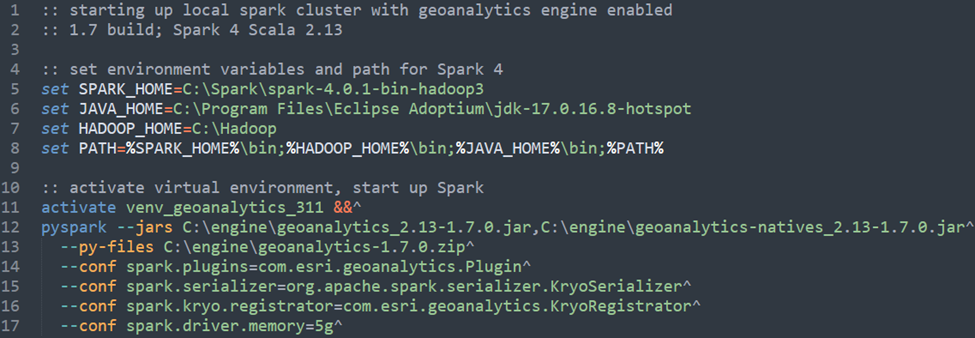

My preference is to automate the process instead of trying to remember all of the commands required to start Spark and load GeoAnalytics Engine, so I wrote a batch file (.bat) to do all of this for me.
In my case, it looks like this – so let’s walk through what this all does:
To start, I set all of my environment variables so that they point to the right version of Spark, Java, and Hadoop. By setting them in my batch script they are only set for this session. This makes it so that I can quickly switch between Spark versions if needed (I have a second batch script that uses Spark 3.x so I can spin that up whenever I need that):
:: set environment variables and path for Spark 4
set SPARK_HOME=C:\Spark\spark-4.0.1-bin-hadoop3
set JAVA_HOME=C:\Program Files\Eclipse Adoptium\jdk-17.0.16.8-hotspot
set HADOOP_HOME=C:\Hadoop
set PATH=%SPARK_HOME%\bin;%HADOOP_HOME%\bin;%JAVA_HOME%\bin;%PATH%
Next, I activate my virtual environment with PySpark installed. In this example my virtual environment is named venv_geoanalytics_311 (because it uses Python 3.11).
:: activate virtual environment, start up Spark
activate venv_geoanalytics_311 &&^
Finally, we’ll set up the portion of the script that starts up Spark with GeoAnalytics Engine enabled. In this section we do a few things:
- --jars: Point it to the GeoAnalytics Engine jars.
- --py-files: Point to the GeoAnalytics .zip file with the python files
- --conf: Set all of the configuration settings that you want/need for the Spark environment. In this example I have a very basic set of the required configurations, but you may opt to include other specific configuration settings based on your needs.
pyspark --jars C:\engine\geoanalytics_2.13-1.7.0.jar,C:\engine\geoanalytics-natives_2.13-1.7.0.jar^
--py-files C:\engine\geoanalytics-1.7.0.zip^
--conf spark.plugins=com.esri.geoanalytics.Plugin^
--conf spark.serializer=org.apache.spark.serializer.KryoSerializer^
--conf spark.kryo.registrator=com.esri.geoanalytics.KryoRegistrator^
--conf spark.driver.memory=5g
Note: If you are working with a Disconnected license for GeoAnalytics Engine, you will want to add an additional configuration setting to point to the license file. This would look something like this, but with the direct path to your license file specified:
--conf spark.geoanalytics.auth.license.file=license_file.ecp

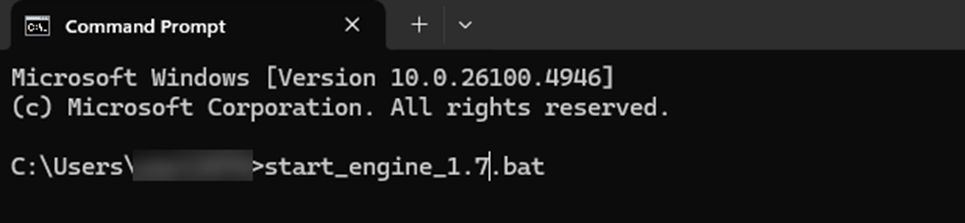

Now that this is all put together, I can just run my batch file from the command prompt. When I run the script it should start up Spark, load the GeoAnalytics Engine jars, and open a Jupyter notebook (based on the Path variable for PYSPARK_DRIVER_PYTHON).

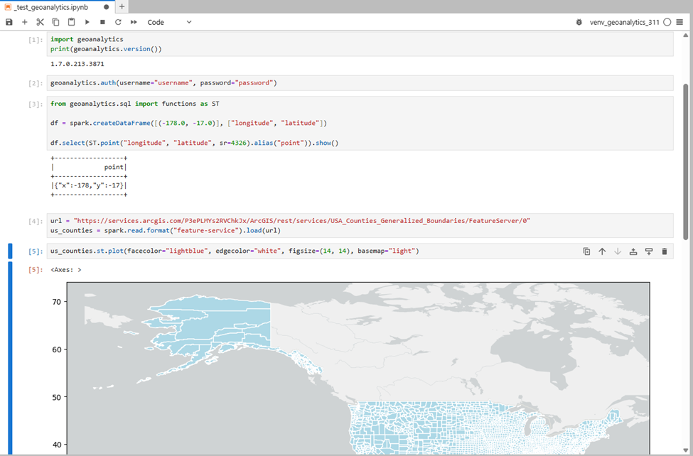

Then I can confirm that everything works by trying some simple code in my Jupyter notebook:
