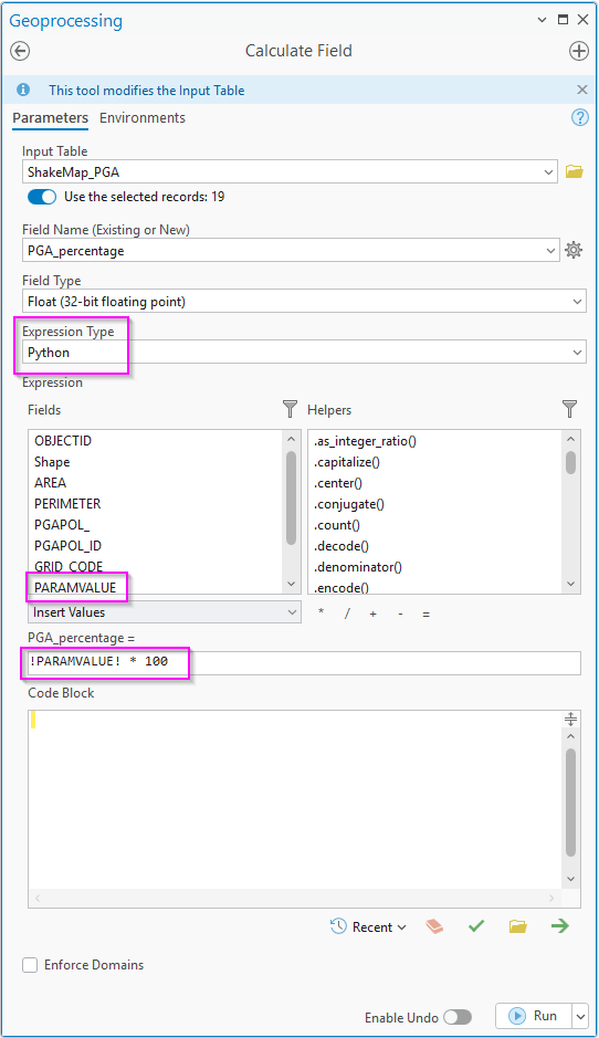

The Field Calculator in ArcGIS Pro is a key tool in working with attribute values. This is an advanced article using it with Python programming, but I’ll skim over the basics first. If you’re an advanced user who just wants the goods, skip/skim over this section.

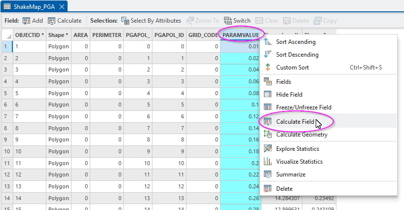

The Field Calculator, also known as the Calculate Field geoprocessing tool, is a handy way to set the value in a field for every record in a feature class’s attribute table (or stand-alone table). The simplest way to open it is to open the table, right-click on a field, and select Calculate Field from the context menu. That opens the tool with the table and field already filled in.
You can also search for the Calculate Field tool in the Geoprocessing pane in Pro or the Command Search box in Pro’s title bar.
The most basic way to run it is to do the same calculation on all the values. In this example, we convert a decimal value to percentage (multiply by 100), but any Python expression works here. A field named PARAMVALUE is my input. If we double click on it from the field list, it appears delimited by exclamation marks in the expression below. We can treat this field name surrounded by exclamation marks like any Python variable. When the tool runs, it will be the row’s value for that field.
Notes:
- We can add multiple fields to our expression.
- In this case, we have a selected set, so it asks if we only want to use those records. Without a selected set, it works on all records in our table.
- We specified a field name that does not exist in the table. That causes it to create a new field, so it also asks what field type we want.

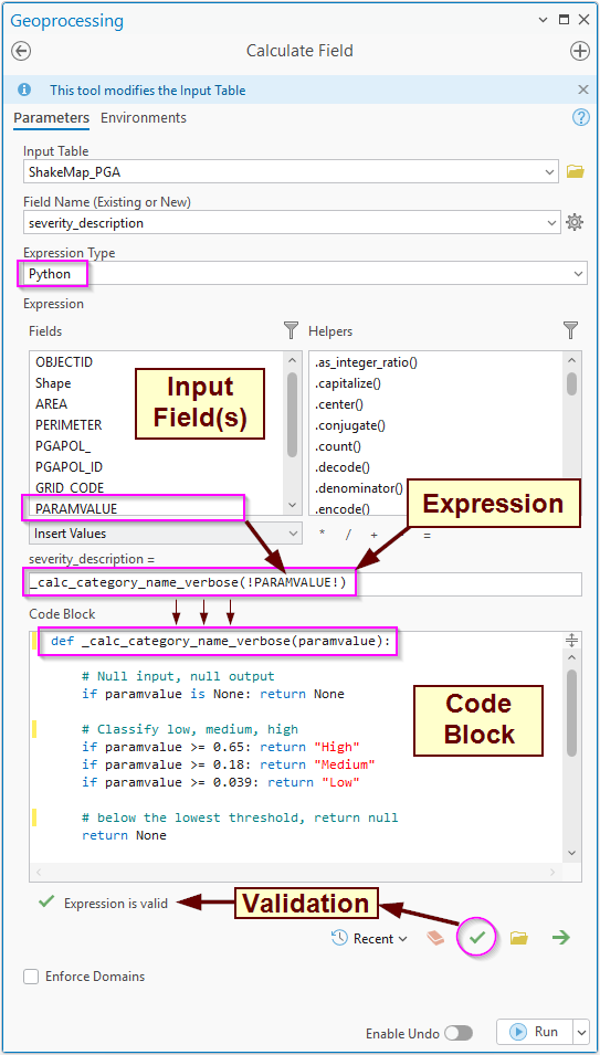

But what if we don’t want all records processed the same way? This is where the Code Block text box comes into play. We can write a Python function (def) to do the processing. The expression will call that function by name and pass the referenced field value(s) to it. Note that this function is called once for every record in your table.
Notes:
- The field values in the expression are delimited by exclamation marks, just like before, but now they are passed as arguments to the code block function.
- In the code block, our function’s arguments must correspond to those passed in from the expression. We can name the arguments whatever we like; they don’t need to match the field name, but keeping it almost the same in this example helps with clarity. If we’re creating a reusable function to work with other tables, it would be better if the names were more generic (e.g.: input_decimal).
- This works like any Python function. We can use a return statement to end processing before the end of the function.
- The green check icon at the bottom validates your code block. This tells you if it is valid Python syntax. It does not tell you, however, if your response makes any sense or will crash with unexpected input values.

The Geoprocessing tool interface is fine for simple use cases, but let’s move to an actual Python environment before we get into more advanced usage. A good way to get started is to run it in Pro from the interface, open the History pane, locate the Geoprocessing run, right-click on it, and get its Python syntax from the context menu:
For this example, here is the resulting code. It’s easy to match the choices in Pro’s user interface to the arguments in arcpy. The code block is highlighted in the screenshot below. The code block is just a text string spanning multiple lines. Note how it starts with “def”, meaning it could be a Python function if we copy/paste this into a script, but for now, it’s just a string. Wrapping it in triple-quotes enables our string to include carriage returns, apostrophes, and quote marks.

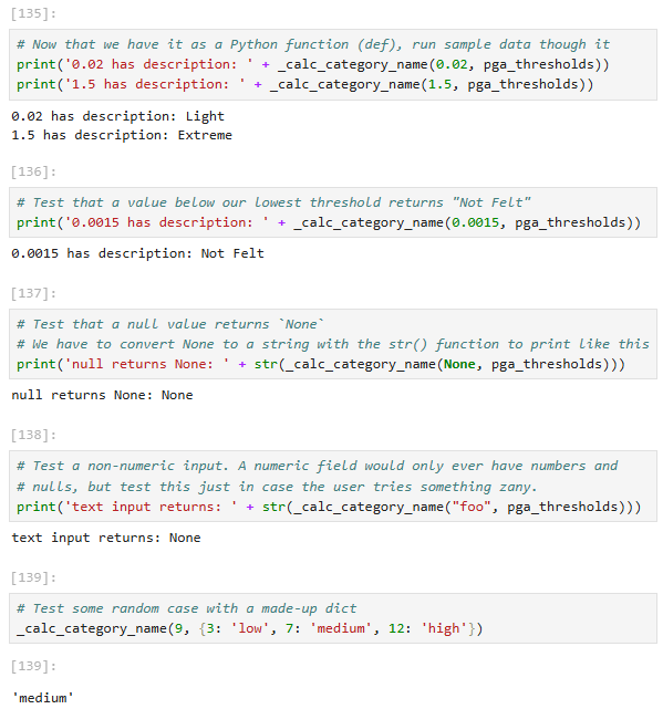

Basic Testing
Now that we have an input dictionary and a function, we can use our ArcGIS Notebook to run some tests on it. We can call it in a Notebook cell like this:
Let’s clean that up using the print function and run a few more tests:
For very simple code blocks and data sets, this testing is good enough. Once you’re satisfied, copy/paste the function’s source into the Geoprocessing tool’s code block text box in Pro. You can also run it in Python with arcpy. You should spot check your results in the attribute table and this might be all you need. For complex use cases (long functions or complicated data sets), you will want more robust testing, troubleshooting, and validation. I promised you we were going down the rabbit hole on this, so keep reading if that sounds interesting to you.
This case is in the attached ArcGIS Notebook and also script #1.

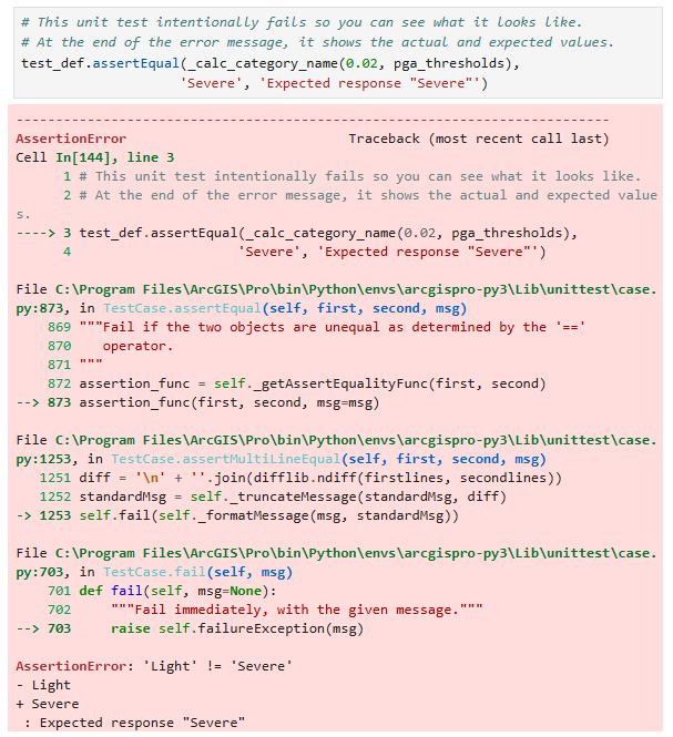

'Light', 'Incorrect response from function')This next example demonstrates what a failed test looks like as it raises an AssertionError. In this example, we pass in the same value as before. It still returns Light, but this test expects a response of Severe, causing the test to fail.
Note how the actual value, the expected value, and the error message are on the last lines of the output.
These examples are a greatly simplified shortcut to how unit tests would normally be run. Check out the link above if you want to learn more. These unit test examples are in the attached ArcGIS Notebook.

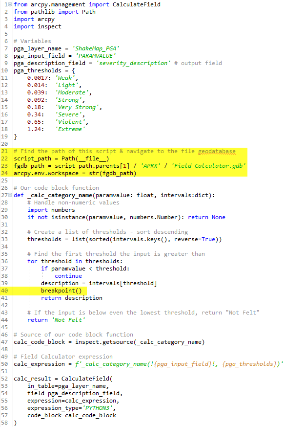

calc_result = CalculateField(
in_table=pga_layer_name,
field=pga_description_field,
expression=calc_expression,
expression_type='PYTHON3',
code_block=calc_code_block

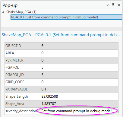

)The Geoprocessing tool doesn't output any meaningful response in our Notebook. If we open the attribute table or a feature’s popup, we can see the new field with the text description populated:
This code is in the attached ArcGIS Notebook and script #2.

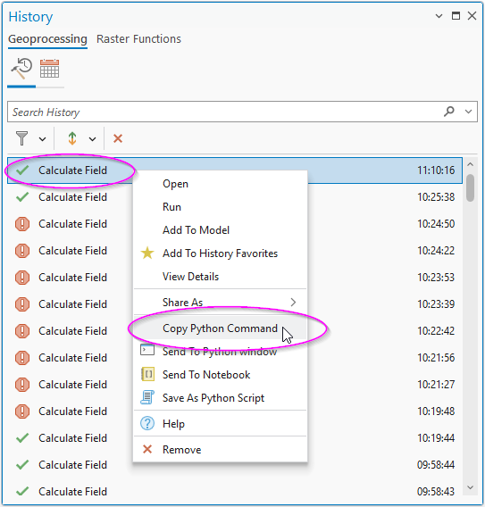

Troubleshooting the Field Calculator

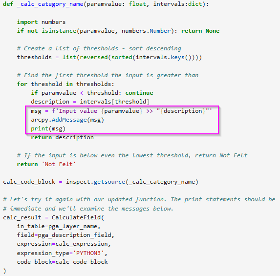

If you work with the Field Calculator long enough, especially with complex calculations, you will experience a failure that is tricky to diagnose, much less fix. The Field Calculator can produce notoriously opaque error messages when it fails. Or we get a detailed error message, but have no idea which input value from the table caused it.
How do we troubleshoot it? The most basic troubleshooting tool of all is the print statement. The arcpy Geoprocessing framework also has a messaging queue we can write to. Let’s try both of these.
First, I tried print statements and arcpy messages in a code block in Pro’s interface, but neither produced any output. If you know how to do this, please leave a comment. We might be able to use Python loggers to output to a file, but this seems overly complicated for the tiny code block textbox.
In this example, we modify the previous code block function slightly. We create a string with our message, add it to the Geoprocessing messages, and also print it. Just like before, we retrieve the updated source code and run the tool.
Here is the output from this cell in our ArcGIS Pro Notebook:
Input value 0.01 >> "Weak"
Input value 0.02 >> "Light"
Input value 0.04 >> "Moderate"
Input value 0.06 >> "Moderate"
[...SNIP...]
Input value 0.34 >> "Severe"
Input value 0.36 >> "Severe"
Input value 0.38 >> "Severe"
Success! When doing this, be aware that:
- The code block has 3 return statements, but this example only prints output for one. You can try adding it elsewhere.
- If the function fails before it prints anything out, we may not get the desired output. In chasing a bug, we might add another print statement earlier in the code. This can lead to adding too many print statements, which can clutter up the code and create too much output.
- Once we zero in on a condition that triggers the error, it might be better to wrap the code to print inside an if statement, so it only prints under the conditions causing the error.
- Use caution when running this against a very large table. Similar to the previous bullet, we may want to implement a counter to only print the first 20 records or something like that.

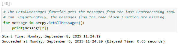

What about our arcpy messages? The arcpy function GetAllMessages returns the messages from the last tool run. Let’s print them out:
As you can see above, they are missing. We only get a message when the tool starts and finishes – the same as any run. My best guess is that the code block is run in another process with its own message queue, which is lost when the code block ends.
If you know how to retrieve these, leave a comment. The print statements are probably good enough, so I didn’t pursue this any further. You could also create your own list variable and append messages to it if you wish (see below for how to use global variables inside your code block).
This example is in the attached ArcGIS Notebook.

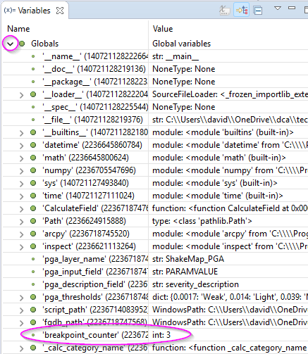

Debugging With Breakpoints

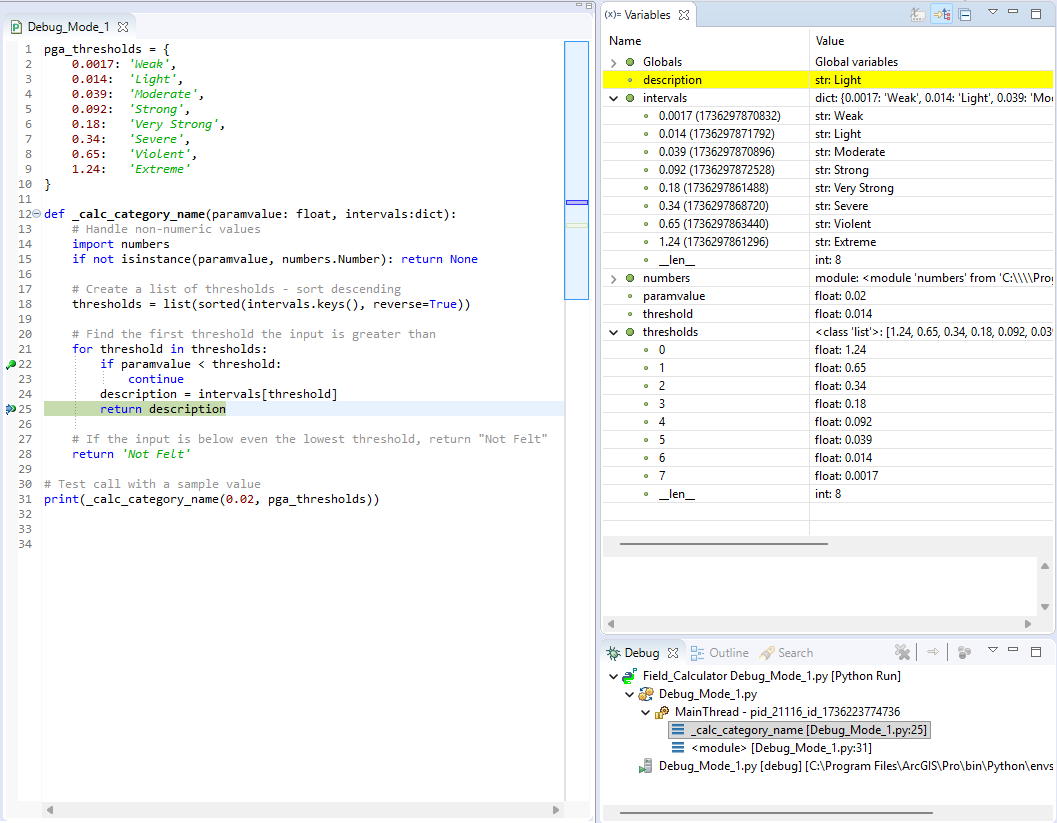

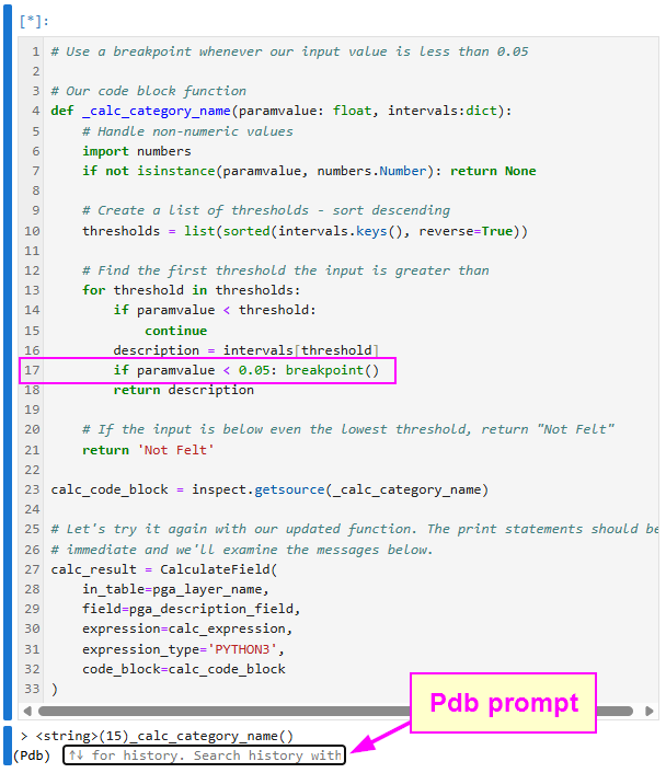

So far, we’ve tested the code block against a wide range of input values and added print statements to diagnose errors. But we still haven’t gone all the way down the rabbit hole of debugging it. For that, we will use a tool called a breakpoint that pauses the code to let us inspect it.
What Are Breakpoints?
One of the most powerful tools in troubleshooting Python code (or any language) is the ability to set a breakpoint at a given line of code. This pauses the code execution before it executes that line. While paused, we can do the following:
- Inspect the variables at the local or global scope to discover their type and values.
- Execute commands: After pausing at a breakpoint, we have a Python command line with everything from our program available to us.
- For example, we can run functions or change the value of variables. This lets us experiment with what would happen if one or more variables had a different value.
- View our current stack: The stack is the series of scripts, packages, and functions that have been nested to get to the current point in our code. We might start out with a .py script, call something in arcpy, which in turn utilizes another Python library, which might call something else. All of those go on our stack. When our code is failing, this is a key way to see how we got there.
- Once we’re ready to proceed, we can run our code in several ways:
- Continue one line at a time.
- When we get to a line running a function or creating a new object, we can “step into” it (go line-by-line through it) or “step over” it (run it and move to the next line of code at the current level). And if we find ourselves going through code at a lower level of detail than we need, we can “step return” to go back up a level.
- Resume our code running as normal, noting that any subsequent breakpoints will pause it again. (This includes a breakpoint placed in a loop, which will pause every time it reaches that line.)

Debugging the Code Block Function
Just like we added print statements to the code block function, we can add breakpoints. In the screenshot below, I am using the Eclipse Integrated Development Environment (IDE) with the PyDev plugin. This is just a bare-bones Python script where I have set breakpoints on lines 22 and 25. Because these are inside a for loop, it will stop each time it reaches these lines in the loop.
There’s a lot going on here, so let’s break down the screenshot above:
- Line 25 is highlighted in green. This indicates that the code running in debug mode and currently paused on this line.
- In the variables pane on the right, you can see all the variables currently in use and their values. Lists, dicts, or any hierarchical variables can be expanded. Any value that changed since the last breakpoint is highlighted in yellow (only one in this example).
- The Debug pane on the lower right shows the stack of everything that’s running. With just one function in this script, this is pretty simple, but this can be really complex in other cases.
In the toolbar, there are buttons to resume running, terminate, and step through the code in the various ways discussed above.
This function is simple enough that running it in debug mode might be overkill. As our code grows more complex, however, breakpoints are a key tool for development and troubleshooting.
That said, when developing in an IDE like Eclipse (or VS Code, PyCharm, etc.), setting the breakpoints is just done visually in the editor (e.g.: the green dots in the margin of lines 22 & 25). Recall that what we pass the to the Field Calculator is not the function itself, but rather a text string of the function’s source code. In other words, when we use inspect.getsource() on our function and pass that string to the Field Calculator, Python won’t respect the breakpoints. In the next section, we will discuss how to set breakpoints in a way that is embedded in our code block function’s source code, so it is portable to the Field Calculator.
Using Breakpoints in the Field Calculator
To make the Field Calculator respect our breakpoints, we need to add them to our code, rather than just using the interface of our IDE to set them. To move this from ArcGIS Pro to my Python IDE, I had to make a few changes to the ArcGIS Pro Notebook we've been working with. Here is the script we will work with, below. It is attached as script #3. In particular:
- Additional imports at the top
- Lines 21-24: A new way to set the workspace environment variable using the currently running script’s path.
- Line 40: Add a breakpoint() call, the equivalent of setting a breakpoint in my IDE.
That’s it! When we run the script, we can now see all the variables set within our code block as it executes. Note that the Field Calculator calls this code block function for every row in our table which pauses on the breakpoint each time. The screenshot below shows the debugging information, noting that this is just for one sample row. The IDE highlights the 3 variables that changed since the breakpoint on the previous loop.
I don’t often use this, but there is also a Python command prompt where we can execute commands while we’re paused for a breakpoint. One thing we may want to try is updating variables. In this case, I modify a description right before it is returned from my code block.
If I check in Pro, here is that feature:
Note that there are 3 return statements in my code block, but only one has a breakpoint. This is good enough for this demo, but we could insert additional breakpoints, as needed.

When it stops, debug mode shows us all the same things as before, but where’s our counter? Debug mode shows us the local variables, but recall that this is a global variable, as signified by the global syntax.
If I expand the global variables, there it is.
In this example, we create a global variable before calling the Field Calculator and then our code block function updates it each time it is called. Our code block function could use this approach to pass back any kind of data to our main script as we loop through the table.

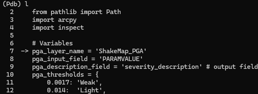

- n: Execute next line
- s: Step into the code for a function or object
- r: Return, continue to the end of the current function
- l: Show where we are in the code (11 line summary)
- ll: Same as l, but a longer listing
- break <#>: Break on line number. This is tricky inside the code block function because the line numbers are relative to the start of our def. This is easier to use outside the code block function where the line number corresponds to the Python file.
- break <function_name>: Break when we reach this function. This is handy to stop at the beginning of our code block.
- q: Quit the program

Debug Mode in ArcGIS Pro Notebooks
Notebooks (running in Pro, Jupyter, Enterprise, or ArcGIS Online) are inherently great for debugging. We can create a cell with a few lines of code, run it, and then poke and prod at the values in the next cell. That’s exactly what we did above in our very first tests. You might be wondering if we even need debug mode when notebooks will pause whenever a cell finishes executing. Running a cell in a notebook and pausing to inspect the results is missing two key capabilities that are relevant to the Field Calculator:
- Pausing to debug within a loop is one of the most common use cases. If a notebook cell has code that loops, the notebook will run that loop to completion before pausing. The Field Calculator loops through the records in our table, but notebook cells don’t have a way to pause on each one.
- We can make notebooks pause our code anywhere we want by putting as few lines of code in a cell as it takes to isolate a problem. But what if our code calls external functions, such as the Field Calculator? A notebook will execute all the external code called by our cell before pausing, whereas debug mode gives us the ability to step into that code.
Fortunately, ArcGIS Notebooks do support debug mode. In this example, we add a breakpoint when the input value is less than 0.05 (our table has 3 of these).
Once it hits the breakpoint, we get a Pdb prompt with a blinking cursor. We don’t need to rehash all the command usage covered above, but this screenshot gives you a basic idea of how it works. Here is an example of running one (recall that we have 3 records with a value below 0.05):
Notes:
- I tried to use the global variables to create a breakpoint counter like we did previously. This produced the dreaded 999999 error from the Field Calculator running a Notebook in ArcGIS Pro. I’m not sure why it crashes when I try to use global variables.
- The commands l and ll, don’t work here. I sometimes get this at the command prompt, too.
- The line numbers don’t exactly align, but we can figure them out. Note where it says (15) over and over -- that’s our breakpoint’s line number. Since our function’s source starts on line 4 of the cell, let’s subtract 3 from each line to make that line 1. Our breakpoint() call is on line 17 of the cell, or subtracting 3, on line 14 of the function. My best guess is when the inspect module reads the source in, the if statement and the breakpoint() call on line 14 are considered separate lines of code, putting our breakpoint on line 15. When debugging, if you’re having trouble with line numbers, you might want to start your function at the top of a cell (on line 1) and avoid adding code on the same line as an if statement.
- When we hit the last breakpoint, the final continue call just ended the Pdb prompt mode, the cell’s code finished executing, and the next cell in the notebook was activated.
This wraps up the section on breakpoints. To be honest, I almost never use these. Debugging in an IDE is so much more intuitive. As discussed above, we did need to use the breakpoint() call to pause the Field Calculator code block, but I would still prefer to do that in an IDE, rather than at the command prompt.
