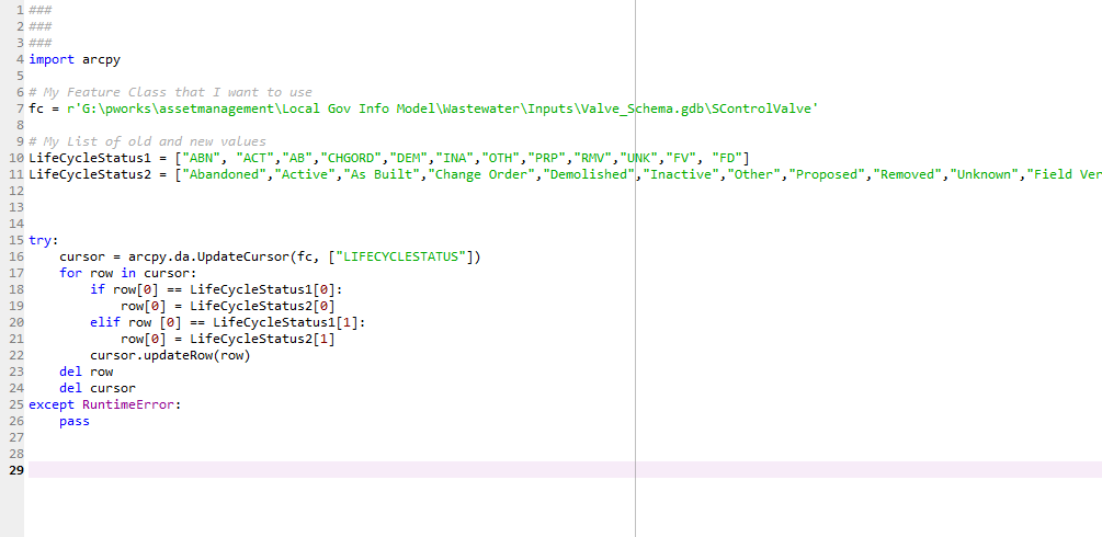

I am trying to use arcpy.da.UpdateCursor to find and replace old values in a field with new values. I have made it work but I will ended up with an ridiculously lard if\elif statement (notice below that I stopped after the first 2 items in the list). I would like to avoid this by iterating through both list to update the field. I have tried without any luck. Any suggestions? Code is attached.

The issue i'm running into is that I don't want it to print 100 times "not in list." I just want it to total up the number of times other values are found.
I notice in your second code posting, you are running multiple update cursor loops, once for each item in your list (line 12). With either the indexing solution from Joshua or the dictionary solution, only a single pass with an update cursor is needed and is more efficient.

Thanks for all the responses! Right after I posted this I figured it out how to do it this way. Any suggestions on adding an elif statement that will tell the user if there are any values in the field that are not in the list? Example: "ANB" instead of "ABN"
