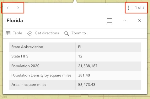

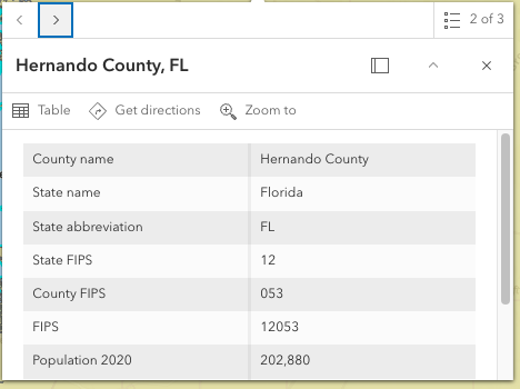

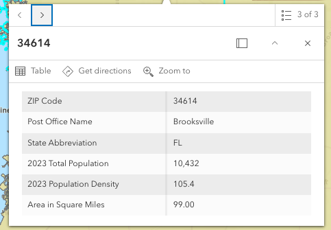

By default, when I click on a location on the map, the Map Viewer will display a single popup window, with an arrow to page through all of the layers:

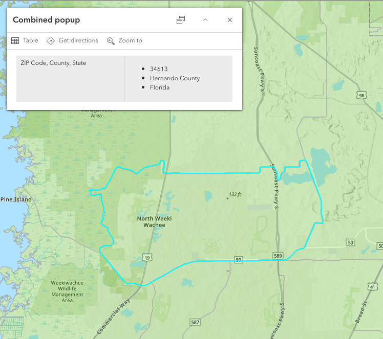

What if you want a single popup window displaying information from each of the layers, with no need to page through the layers popup windows as above. Something like this?

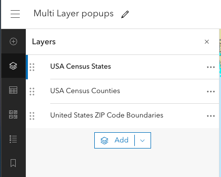

To begin with, In the web map I DISABLED popups for the County and State layers.
I ENABLED the popups for the ZIP Codes layer.

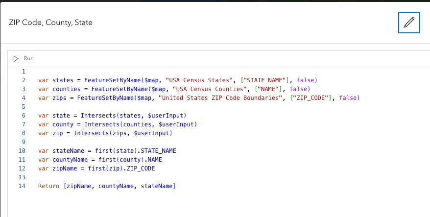

I then added an attribute expression to specify the Arcade code to be run when I click on the map.
I named the Arcade expression "ZIP Code, County, State"
I wrote this code in the expression window
This code does the following:
First, get the FeatureSet for the states, counties and zip codes layers
https://developers.arcgis.com/arcade/guide/types/#featureset
https://developers.arcgis.com/arcade/function-reference/featureset_functions/
var states = FeatureSetByName($map, "USA Census States", ["STATE_NAME"], false)
var counties = FeatureSetByName($map, "USA Census Counties", ["NAME"], false)
var zips = FeatureSetByName($map, "United States ZIP Code Boundaries", ["ZIP_CODE"], false)

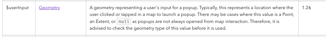

Next, we want to use the location where you clicked on the map ( $userInput ) to find the intersecting state, county, and zip code
https://developers.arcgis.com/arcade/profiles/popup/
var state = Intersects(states, $userInput)
var county = Intersects(counties, $userInput)
var zip = Intersects(zips, $userInput)
Then, we want to pull the values for the fields we are looking for and assign them to variables. So we get the first record (there should only be one) and extract the field value we want
https://developers.arcgis.com/arcade/function-reference/array_functions/#first
var stateName = first(state).STATE_NAME
var countyName = first(county).NAME
var zipName = first(zip).ZIP_CODE
Then finally we build an array [var, var, var] of the variables and pass it back to the attribute expression
Return [zipName, countyName, stateName]

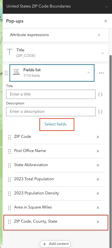

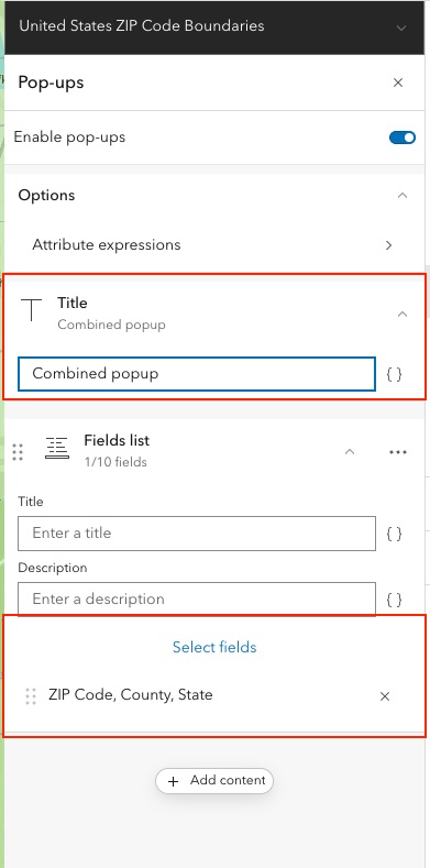

In the ZIP Code layer popup we use the Fields List to add the attribute expression to the list of fields to be displayed
Click Select Fields and add the ZIP Code, County, State attribute expression to the fields to be displayed

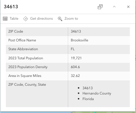

Once you have saved your changes, you should see this for the map popup when you click on the map.
You could also turn off other fields you don’t want to show and change th title to something meaningful
