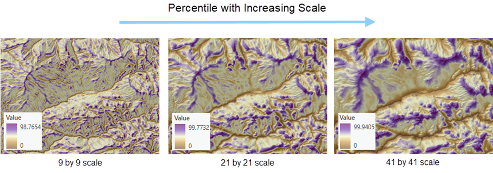

Comparison of percentile values with increasing scale. Purple areas are peaks and brown areas are valleys. Smaller scales are more affected by local variation. As scale increases, larger surface features dominate percentile values.

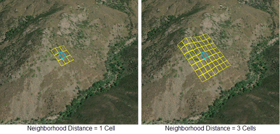

Each of these new tools makes calculations across a range of spatial scales and returns the maximum value for each cell. Here scales are specified through neighborhood distance values. A neighborhood distance is the distance from the target cell center, creating a square of cells around the target cell. To control the scales for analysis, these tools have several optional parameters that identify the minimum and maximum scales and the increment between scales.
Two neighborhood distances for the same center, or target cell.

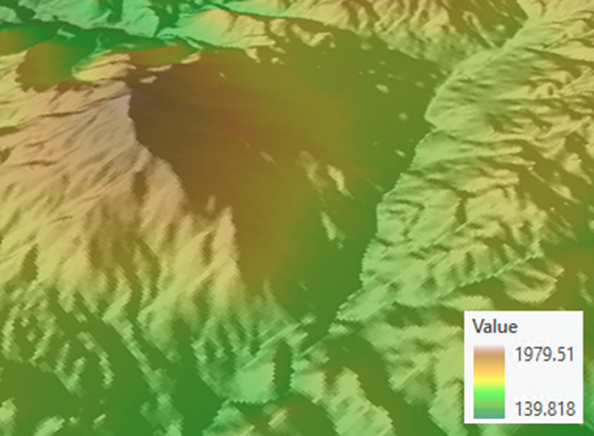

The following exercise explores the hydrologic features in a landscape. A study area is shown below.
The study area of an input surface raster to be used for analysis. Elevation is measured in feet.

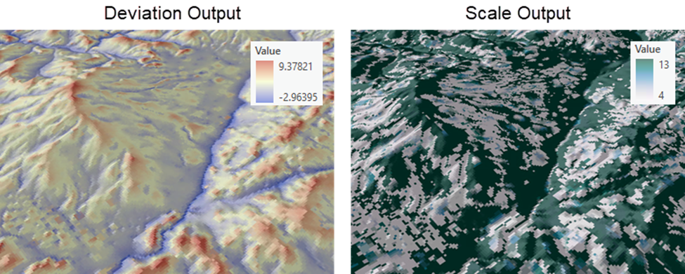

Run the Multiscale Surface Deviation tool with default settings to analyze neighborhood distances from 4 cells to 13 cells with an increment of 1 and a nonlinearity factor of 1. In addition to the primary output, specify the optional output, the scale raster.
Running with those settings produces the following outputs. Higher positive values tend to occur for local maximums (left, red) in elevation while more negative values (left, blue) appear for local minimums. This means that we are potentially identifying ridges or mountain peaks (local maximums) and flat, valley areas (local minimums). Where we see these negative deviation values, the scale output values tend to be for larger neighborhoods (right, dark green). This means that ridges or peaks and valleys can be identified by finding areas with large neighborhood values and either high positive deviations (ridges, peaks) or high negative deviations (valleys).
The deviation and scale output rasters from the Multiscale Surface Deviation tool for the identified study area.

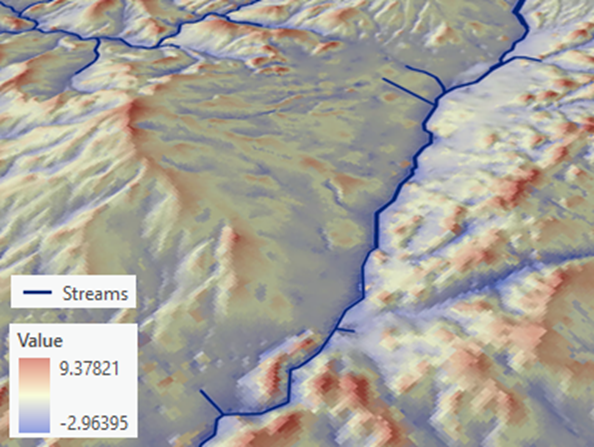

Compare these values with output from the Derive Stream As Line tool from the Hydrology toolset. The streams of this study area closely follow the areas where there is a negative deviation value and a large scale. In real-world water applications, this kind of information is used to enhance elevation derived hydrography workflows.
The deviation output from the Multiscale Surface Deviation tool with streams (dark blue lines) from the Derive As Line tool overlayed.
