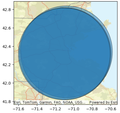

First, let's look at the planar buffer - which was calculated in the units of the input geometry (decimal degrees). This is an 0.5 decimal degree buffer around the three schools:
Note that I left the axis labels on the map so that you can see that this is plotting on a basemap in decimal degrees.

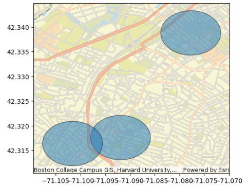

And now, let's look at the geodesic buffers around the schools. Note that this is also plotting on a basemap in decimal degrees. We can see that the buffers are much smaller (500m around each school), and that they are not circular. Let's explore why this is...
There are a few key things to notice when plotting these buffers:
- The buffers in the first plot look huge, while the buffers in the second are much smaller. The "geometry_buffer" is half a decimal degree, while the "geometry_geodesic_buffer" is just 500 meters. One decimal degree is significantly longer than 500 meters. At the equator, a degree of latitude or longitude is close to 111 miles!
- The buffers in the first plot ("geometry_buffer") look circular while the buffers in the second plot ("geometry_geodesic_buffer") look like ovals. Why is this? Both of these maps are generated on a map based on the latitude and longitude coordinates. In these plots, one degree of latitude is equal to one degree of longitude in length. On the earth, the length of one degree of latitude and longitude differ, with a degree of longitude becoming a shorter and shorter length as you get closer to the poles. The Wikipedia entry on Longitude discusses this in nice detail if you would like more information. When the geodesic buffers are plotted on this particular map projection, they appear stretched out into ovals, though, on the earth's surface they would be circular.

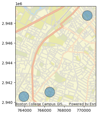

If we were to plot the geodesic buffer in our local Boston coordinate system (SRID 2249), the buffers look like the circles that we would expect.
We can update the map when we plot it by adding an sr (spatial reference) parameter. The example code below demonstrates this. More information on the parameters for st.plot can be found in the API reference.
# plotting the geometry_geodesic_buffer on a map with spatial reference of 2249
df_schools\
.st.plot(basemap="streets", geometry="geometry_geodesic_buffer", alpha=0.5, edgecolor="black", sr=2249);

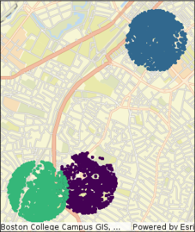

Let's find all of the service requests that are near to each school using the buffers that we created. We'll do that and plot the results in the same bit of code for simplicity, though, for using these types of results in analysis, you might want to create a new DataFrame or add a column with the results instead.
In this example we use a spatial join based on ST_Contains. This finds all of the service call requests that are contained by the buffers around the schools. This is just a simple example; we will discuss more about spatial joins in a future blog post...
# plot the results and color code the service requests based on which school they are near
df.join(df_schools.drop("geometry"), ST.contains("geometry_geodesic_buffer", "geometry"))\
.st.plot(basemap="streets", geometry="geometry", marker_size=5, cmap_values="name");
In this example, the service requests around each school are color encoded based on the school they are near. So we have just created a geometry (Buffer) and used it to identify locations of interest (near to schools). There is more than one way to do this type of analysis, but this shows a simple example using buffer polygons.

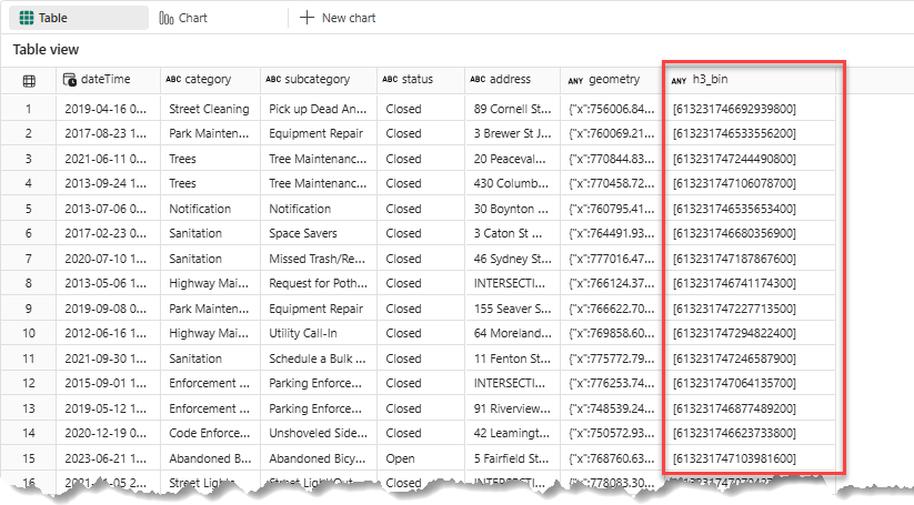

We will start by looking at the ST_H3Bin function to identify the H3 bin that each of our service request points is inside. We will then use a PySPark GroupBy function to make a simplified DataFrame that lists the count of points inside each bin.
The size of H3 bins is based on a resolution value. For this example, we will use a resolution of 8, which equates to an average hexagonal bin size of 0.73 square kilometers. More information on H3 bin resolutions can be found here.

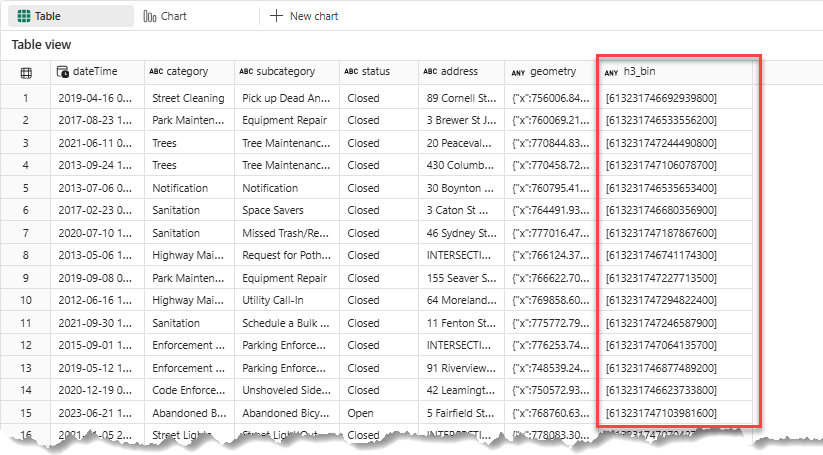

Adding the ID for a bin is as easy as creating a new column for the data and using the bin function for the geometry type you want (hexagonal, square, or H3):
# add a column with the H3 bin _id_ that each point falls inside
df = df\
.withColumn("h3_bin", ST.h3_bin("geometry", 8))
The ST_H3Bin function adds a bin id to each record. It doesn't add the geometry specifically, as there would be many duplicates of the geometry (one for each point inside the bin) and it is more efficient to work with the ID until we need the geometries for analysis or visualization. We can see these new bin IDs in the table below:

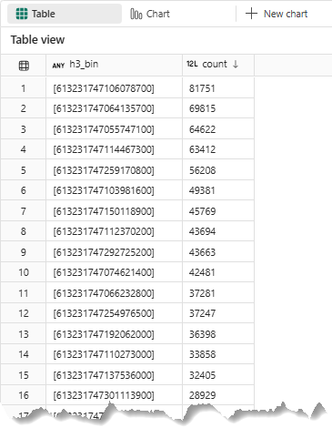

Using the h3_bin ID field, we can then group the values in our table to count the records in each bin.
# group the service requests DataFrame using the h3 bin ID and count all records
df_by_bin = df.groupBy("h3_bin").count()
After grouping, we can see that each bin ID has a count of the number of points inside it. After we do this, we can then convert the bin IDs into geometries and visualize the results.

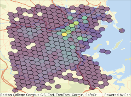

Here is how we add the bin geometry into the tale using the ST_BinGeometry function:
# add the bin geometry based on the bin ID using ST_BinGeometry
df_by_bin = df_by_bin\
.withColumn("geometry_bin", ST.bin_geometry("h3_bin"))
Plotting the results now shows us where the greatest concentration of service requests occurs:

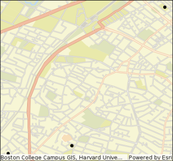

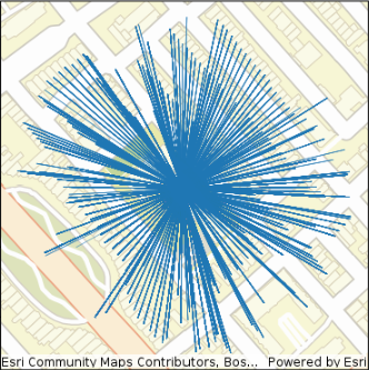

Now that each school has the geometry for the school and the points nearby, we can use those two geometries to calculate the shortest line between each service request point and the school.
# calculate the shortest line from each point to each school
df_schools_requests = df_schools_requests\
.withColumn("geometry_line", ST.shortest_line("geometry", "geometry_school"))
Let's take a look at the result for one school:
# plot the connector lines between one school and all of the points within 500 feet of this location
df_schools_requests.filter(F.col("name") == "Hurley K-8").st.plot(basemap="streets", geometry="geometry_line", linewidth=0.5, alpha=0.7);

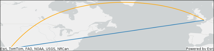

For short distances, ST_ShortestLine is a good choice, but for longer distances, you might consider using ST_GeodesicShortestLine so that the line that is created represents the shortest path on the sphere. As an example of the difference between the "shortest line" (planar calculation) and the geodesic line, we can explore the difference between a line connected between Los Angeles and London. In this example, the geodesic line (orange) appears curved and longer in this projection, but it is actually the shortest line!
# geodesic line (geodesic) (in orange) vs. "shortest line" (planar) (in blue)
# the geodesic line appears curved and longer in this projection, but it is actually the shortest line!
# create points for two locations
data = [
("POINT (-118.2426 34.0549 )", "Los Angeles",
"POINT (0.1276 51.5072 )", "London")
# create a DataFrame with the two locations
# convert the locations from well-known text to geometry
df_lines = spark.createDataFrame(data, ["wkt-origin", "city-origin", "wkt-dest", "city-dest"])\
.select("city-origin",
"city-dest",
ST.geom_from_text("wkt-origin", 4326).alias("geometry-origin"),
ST.geom_from_text("wkt-dest", 4326).alias("geometry-dest"))
# plot the results to compare the two lines generated (geodesic vs. shortest)
myplt = df_lines.select(ST.geodesic_shortest_line("geometry-origin", "geometry-dest")).st.plot(basemap="light", figsize=(10,10), color="orange")
df_lines.select(ST.shortest_line("geometry-origin", "geometry-dest")).st.plot(ax=myplt);

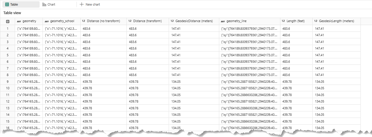

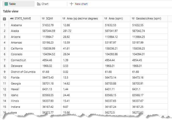

Distance and Length calculations
Now let's look at distance and length for these lines...
- ST_Distance and ST_GeodesicDistance will calculate the distance between two input locations. The unit for ST_Distance is the same as the input geometries. For ST_GeodesicDistance the distance is calculated in meters.
- ST_Length and ST_GeodesicLength will calculate the length of an input feature. The unit for ST_Length is the same as the input geometry. For ST_GeodesicLength the length is calculated in meters.
We will take a look at these calculations using the lines that we generated earlier connecting school locations to the service requests that are nearby.
With the distance calculation, we can also look at a particularly nice feature of the GeoAnalytics library - projection on the fly. If you want to calculate a property or relationship using two geometries that are in different coordinate systems, the library can often reconcile this difference for you so that you don't need to transform the data.
- The geometry (service requests) column is in the Massachusetts State Plane coordinate system (SRID 2249)
- The geometry_school (school locations) column is in WGS84 latitude and longitude (SRID 4326)
Let's use these two geometries and calculate a variety of distance calculations and see how GeoAnalytics can work with geometries in different coordinate systems! In the cell below we are calculating:
- Distance between the two geometries without transforming the coordinates
- Distance between the two geometries with a transformation to convert the geometry_school to Massachusetts State Plane (2249)
- Geodesic distance between the two geometries without a transformation
We will also calculate the length of the line geometry_line that we created earlier to connect the two point locations. We'll perform these calculations and display the results as an example:
display(
df_schools_requests.select("geometry",
"geometry_school",
F.round(ST.distance("geometry", "geometry_school"), 2).alias("Distance (no transform)"),
F.round(ST.distance("geometry", ST.transform("geometry_school", 2249)),2).alias("Distance (transform)"),
F.round(ST.geodesic_distance("geometry", "geometry_school"),2).alias("GeodesicDistance (meters)"),
"geometry_line",
F.round(ST.length("geometry_line"),2).alias("Length (feet)"),
F.round(ST.geodesic_length("geometry_line"),2).alias("GeodesicLength (meters)")
This shows how you can perform these calculations, even with geometries in different coordinate systems! GeoAnalytics for Fabric is great at helping mitigate difference in coordinate systems wherever possible.

For this dataset, let's look at the values calculated by ST_Area and ST_GeodesicArea.
In the example below we display the original data for the state name and square miles, and three new calculated fields, all rounded to two decimal places for readability using PySpark Round()
- area using ST_Area - since the spatial reference is 4326 with a unit of Degree, the results will be in square decimal degrees, which has no real applicable value
- area using ST_Area on a transformed geometry using USA Contiguous Albers Equal Area projection (102003). This calculation returns square meters, so they are converted to square miles in the example below
- area using ST_GeodesicArea on the original geometry. This calculation returns square meters, so they are converted to square miles in the example below
The values returned are all very close to one another in value, but not exactly the same. These deviations are due to distortion in calculation of area for large regions (the Coordinate Systems and Transformations core concept document provides more information on distortion in projections), as well as minor variations in precision that can be introduced with the projection and transformation process.
