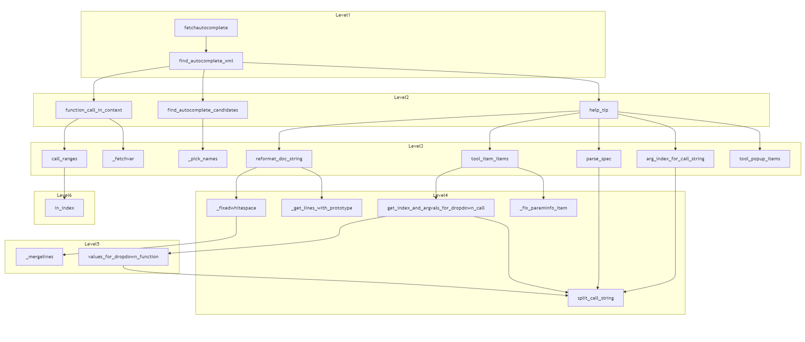

Note2: This is the current function call chain for the autocomplete parsing
Each of these functions is parsing the entire contents of the REPL
