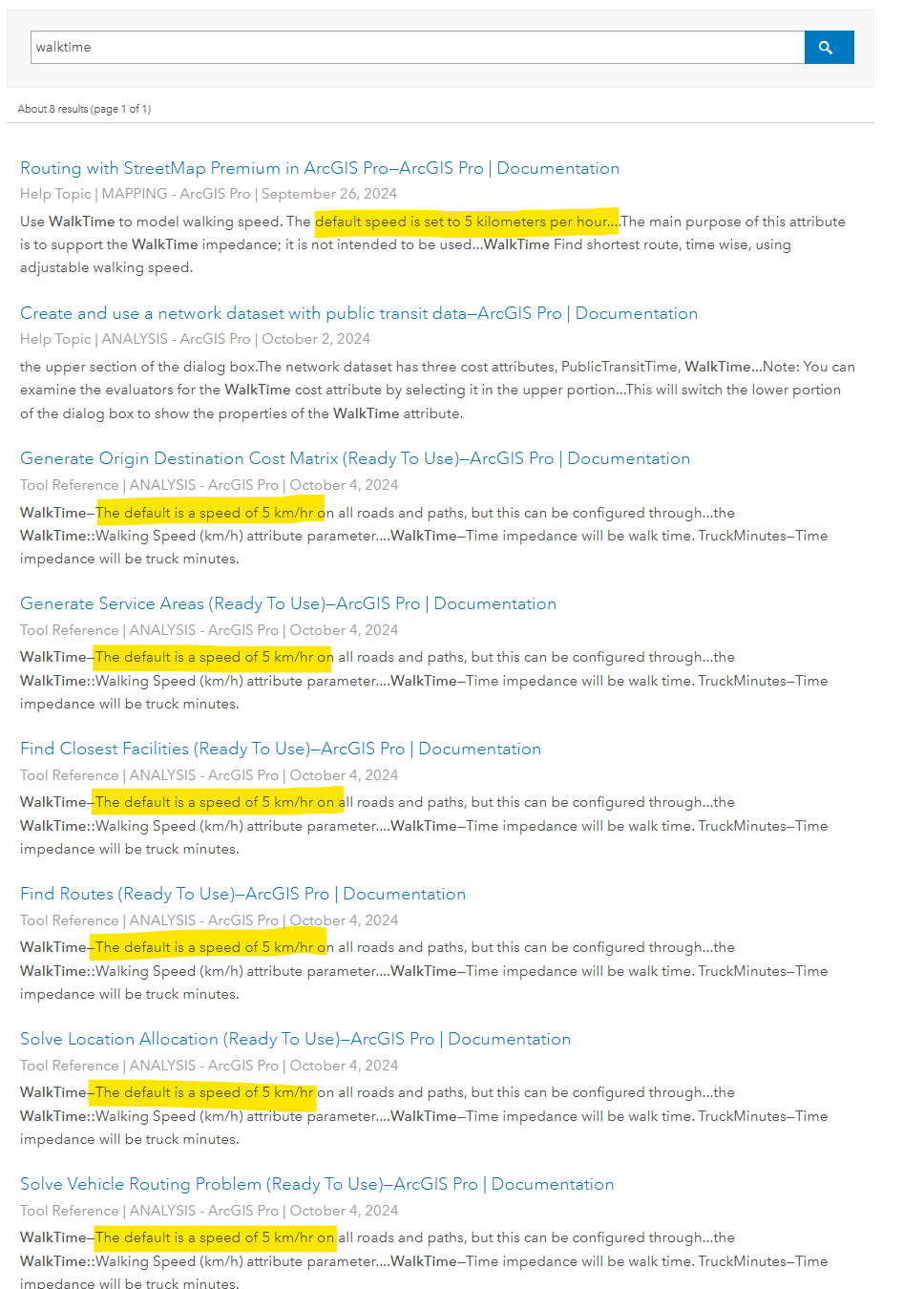

It seems like Esri Network Analysis defaults to 5 km/hr. Has anyone worked on applying different walk_time calculations based on different mobility modes? for example 5 km/hr for "Walking" or 1.5 km/hr for a "Manual Wheelchair" (based on an arbitraty Google Scholar search, https://onlinelibrary.wiley.com/doi/10.1155/2012/753165
https://pro.arcgis.com/search/?q=walktime&collection=help&product=arcgis-pro&version=pro3.4&language=en
