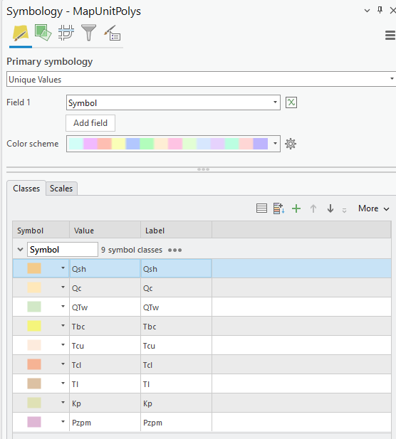

If I have layer, MapUnitPolys, displayed using Unique Values based on the Symbol field,
I would like to save these unique values all at once to an new stylx file, with each style item named as its value in Symbol. Here's what I would like to produce:
