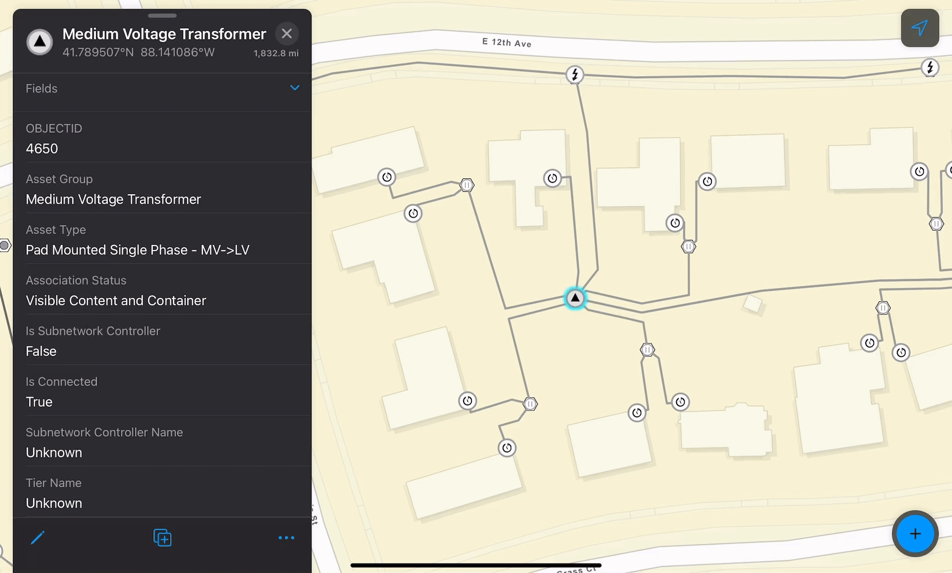

Use output filters to return only the results needed
Output filters let users define what utility network features are included in the trace results by network asset type. Filtering the trace results to only include the features that are relevant to the mobile worker can help to improve efficiency during their assigned work.
Example trace used to identify connected features in an electrical system and using filters to only return fuse features

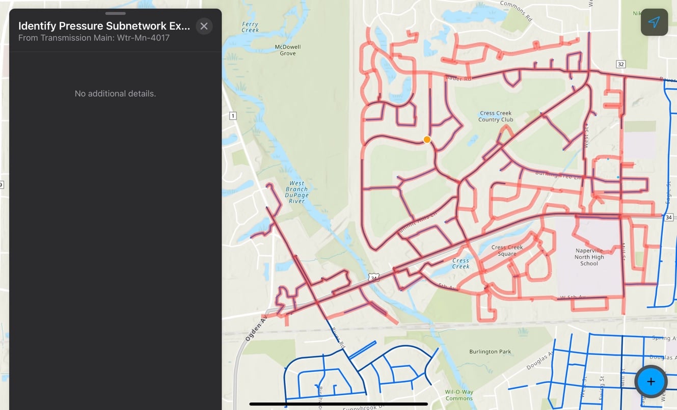

Use the aggregated geometry output
Utility network tracing in ArcGIS Field Maps can help to identify and understand the impact of field work on large areas of the network. When tracing through larger areas, it’s recommended to use the aggregated geometry result type. This allows mobile workers to see the extent of trace results without having hundreds or thousands of features selected on the map.
Example trace used to identify the extent of a pressure subnetwork in a water system

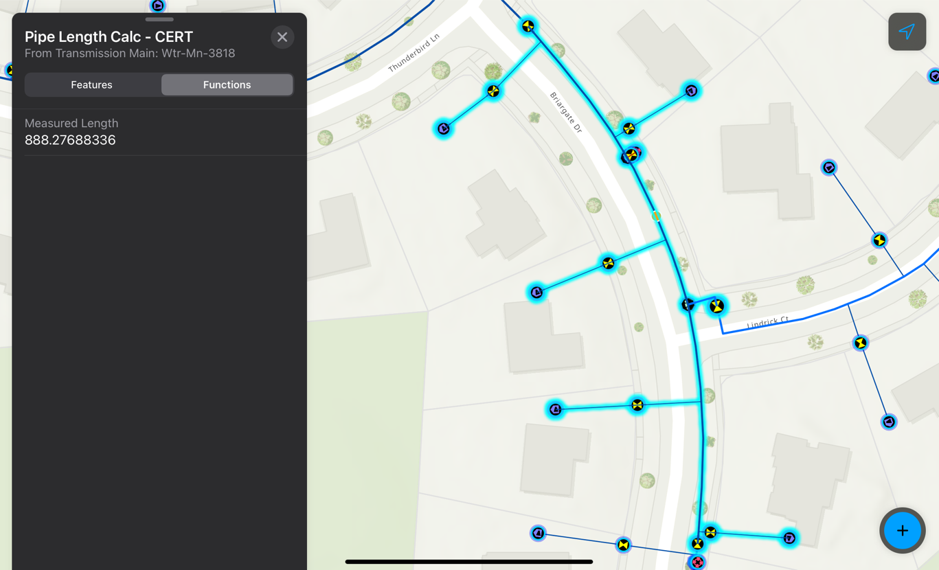

Use functions to summarize information or perform calculations
Functions can be included in utility network trace results to summarize information in the network. For example, functions can be used to count the number of assets or total length of features returned by a trace.
Example trace used to isolate a main break in a water system and calculate the total length of pipe affected

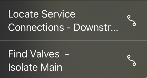

Use descriptive trace names
Traces in ArcGIS Field Maps appear as the name defined in the trace configuration. Include information about the behavior or workflow of the trace being used in the name when configuring utility network traces. This allows mobile workers to understand and identify the correct trace tool to use in the field when multiple traces are included in the map. For example, if a trace is used to identify upstream transformers in an electrical network, you could name the trace Identify Upstream Transformers.
