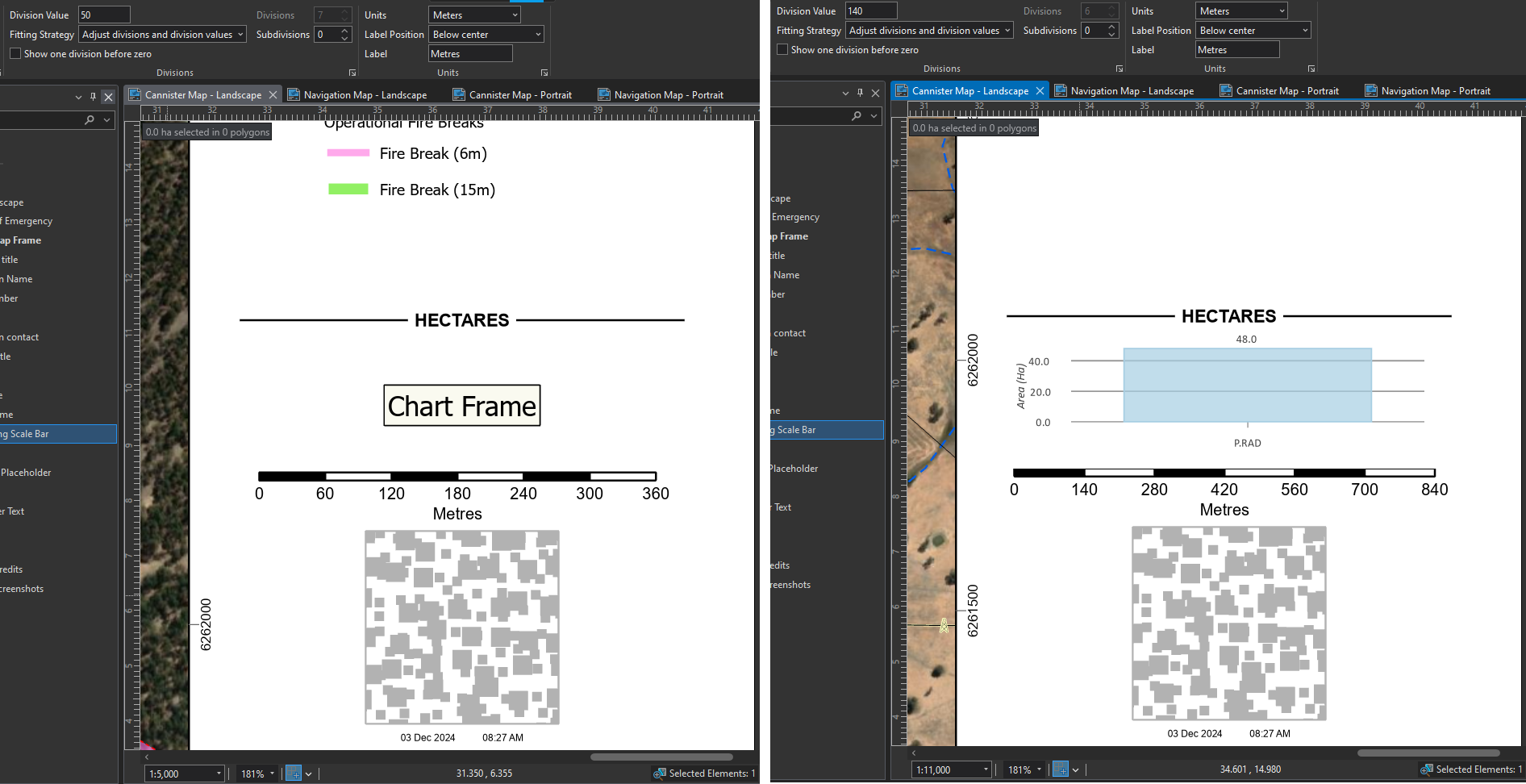

The problem I find is that many of our maps have such variable scales, that no single existing setting gives a nice outcome all the time (typically when using a Map Series). Some examples below show how the scale bar responds at different scales based on the Fitting Strategy selected.
Adjust divisions and division values

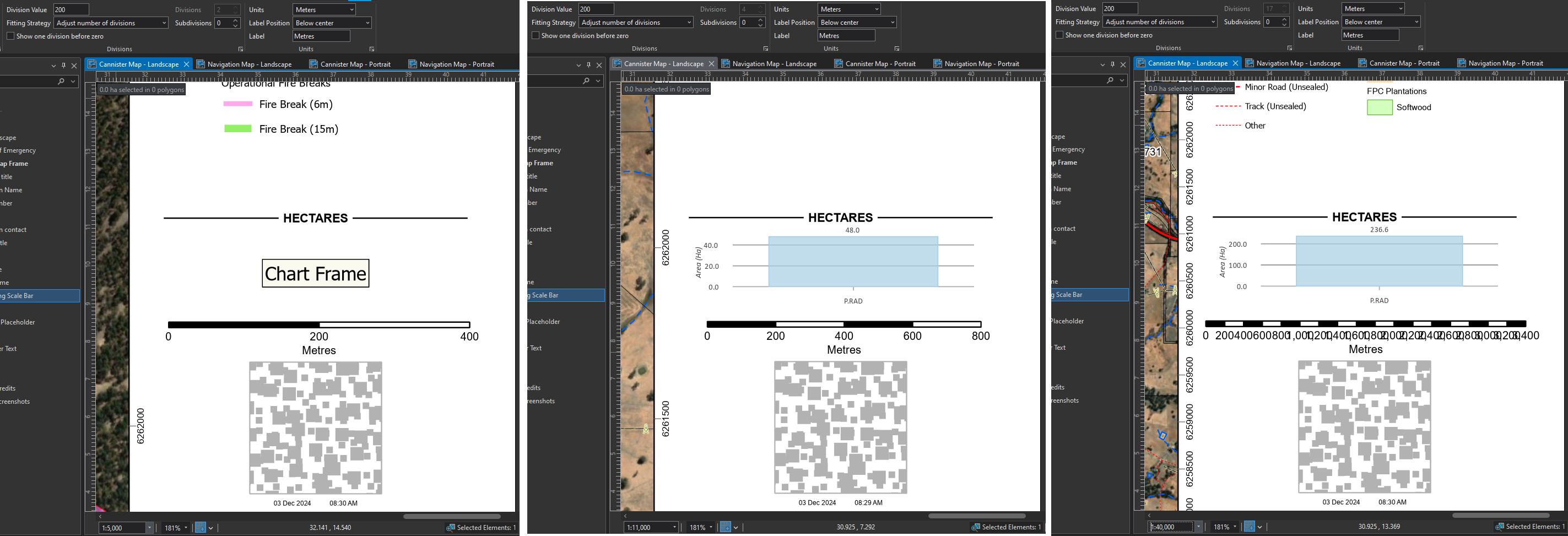

Adjust number of divisions (my preferred option for a nice looking scale bar)

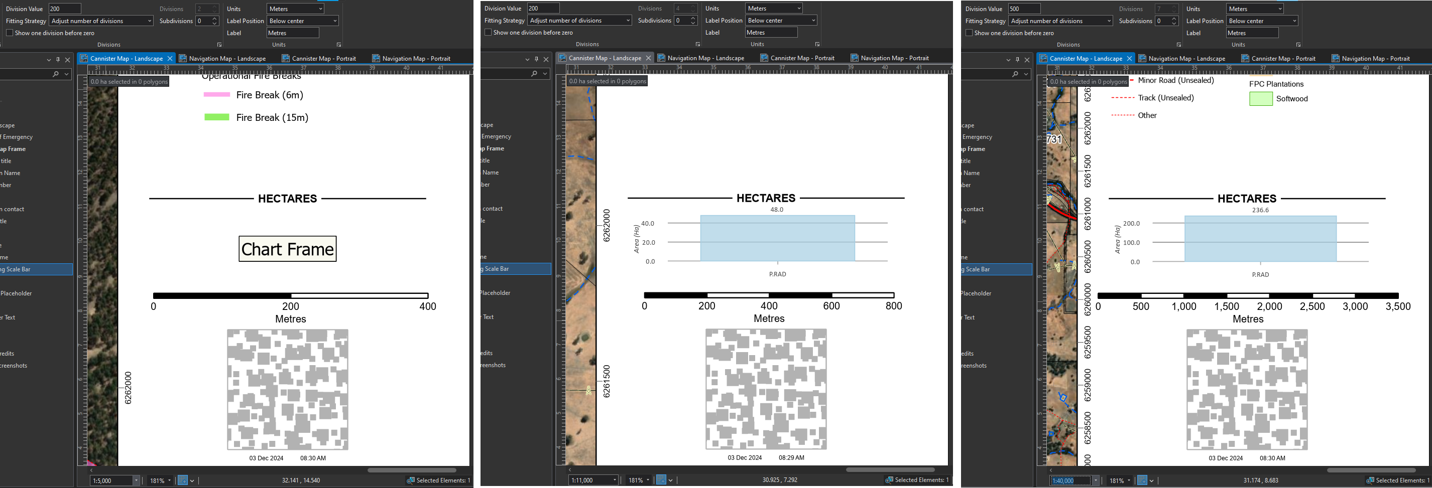

IDEA: When using "Adjust division values" or "Adjust divisions and division values", allow the option to round intervals to a user specified value (e.g. nearest 10, 50, 100, 200, 500, 1000, 5000, etc) AND/OR allow the user to create specific interval values (in a list) for the scale bar to use at different scales (in a similar way to the way the map scales can be customised as per the below screenshot)
Having this level of control would mean that regardless of my map scale (1:5,000 or 1:40,000), my scale bar will present nicely configured division intervals and will still fit within the specified space on the layout (fixed width).
With this sort of function, I could generate maps that look like the below instead of the above.
