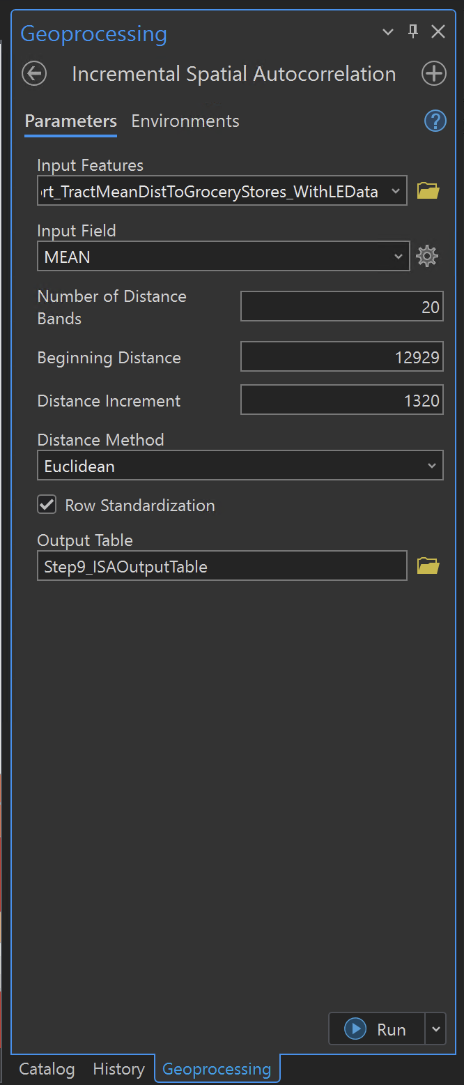

In recent versions (currently observing on 3.3.0), Esri has removed functionality of the Incremental Spatial Autocorrelation tool. It used to spit out a PDF containing a Global Moran's I table and chart. Now, this is only available in a database table or the messages, which I find quite clunky and less useful than the standalone report. Copying/pasting values from the table in messages is especially maddening (what do you mean "copy all?")

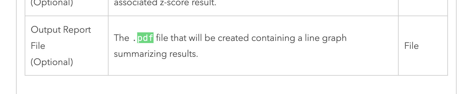

In addition, Esri's own documentation still mentions the PDF output: https://pro.arcgis.com/en/pro-app/3.3/tool-reference/spatial-statistics/incremental-spatial-autocorrelation.htm
But this parameter is missing from the GP tool.
Further--and I understand this is a niche use case--I would like to have students submit this file with their homework. The "improved" method makes this all harder.
