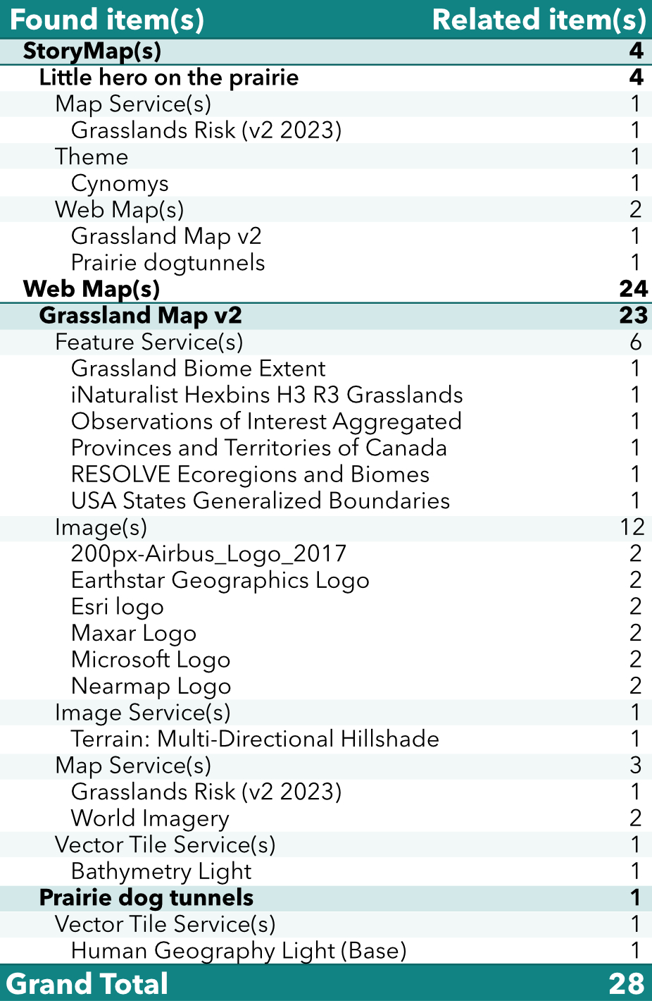

5. Exploring the results: The tool creates several outputs that can be further explored.
- The script will create a ‘related_items.csv’ listing each item in the query and various attributes, including item id, owner, title, sharing, type, and related items. This can be turned into a pivot table (see the example below) to help take stock of items and confirm their owner or sharing level.
This pivot table demonstrates how the output 'related_items.csv' can be used to inventory items like stories and web maps, but also the content within those items or related to those items.
