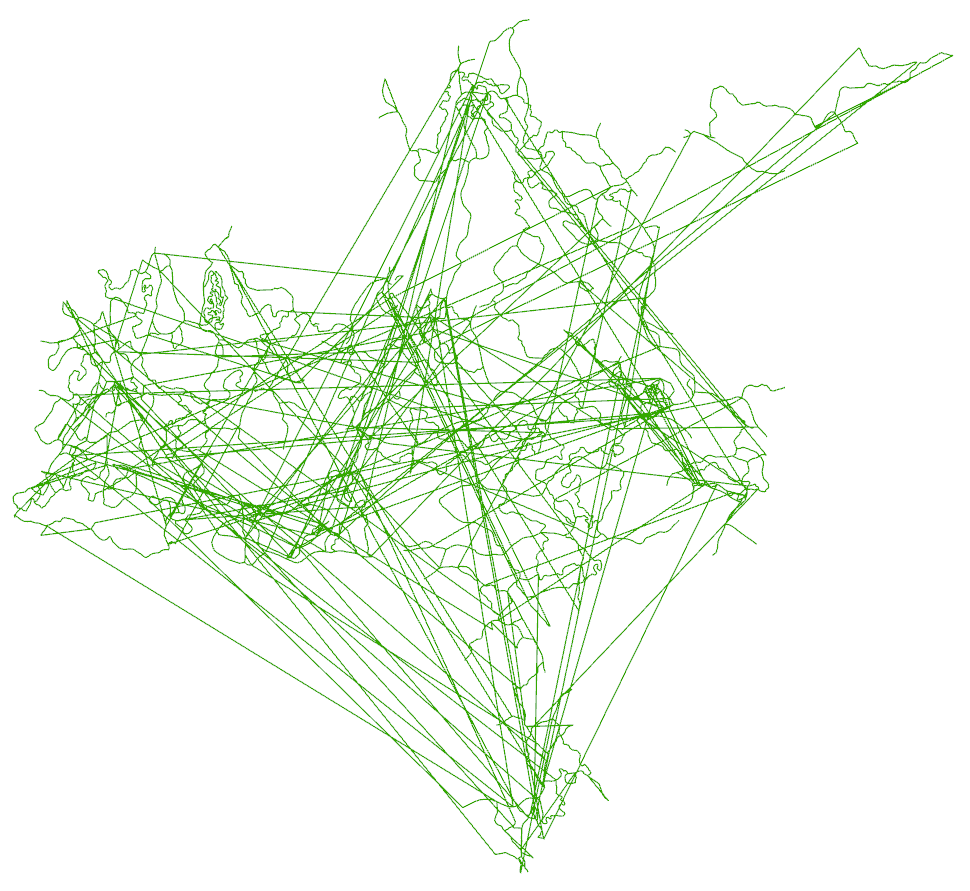

The geoprocessing tool will handle the Berry Pond Road track and the Bay Circuit Trail track correctly (each becomes a line feature in the output File Geodatabase feature class). However, if there are two or more consecutive tracks with the same name (like Healthy Heart Trail) or no name, the consecutive tracks get combined into a single line feature, and it connects the last vertex of one track to the first vertex of the next track. Here is a screenshot of the result:
I'm not sure if the GPX file I was given is a typical GPX file or an oddball one, but it's hard for me to imagine a case where someone would want the result above.
