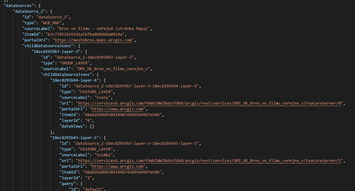

I have link to Experience builder (private one) with URL parametrs using Select and Filter for more data source. In this ExB are only web maps use as data source.
I need to change data source and I have one of then now as feature service with more layer, but I can't.
So my question is: Is it possible to use Feaure layer data source for Filter or Select in URL parametrs?
Original link:
https://experience.arcgis.com/experience/2c3e1dea3b9a43d8b5dd3b426eacd675/page/Detail-filmu/?data_filter=dataSource_4-18ec82959b7-layer-3-18ec8295b44-layer-6:film_survey='Zátopek',dataSource_2-18ec82959b7-layer-3-18ec8295b44-layer-6:film_survey='Zátopek'#data_s=id%3AdataSource_2-18ec82959b7-layer-3-18ec8295b43-layer-5%3a24
data source:
New link
https://experience.arcgis.com/experience/2c3e1dea3b9a43d8b5dd3b426eacd675/page/Detail-filmu/?data_filter=dataSource_4-18ec82959b7-layer-3-18ec8295b44-layer-6:film_survey='Zátopek',dataSource_5:film_survey='Zátopek'#data_s=id%3AdataSource_5%3A24
I found out how it works. Data source name is written as name of dataset-number of layer. Example of my link:
https://experience.arcgis.com/experience/2c3e1dea3b9a43d8b5dd3b426eacd675/page/Detail-filmu/?data_filter=dataSource_4-18ec82959b7-layer-3-18ec8295b44-layer-6:film_survey='Zátopek',dataSource_5-0:film_survey='Zátopek'#data_s=id%3AdataSource_5-1%3A24
