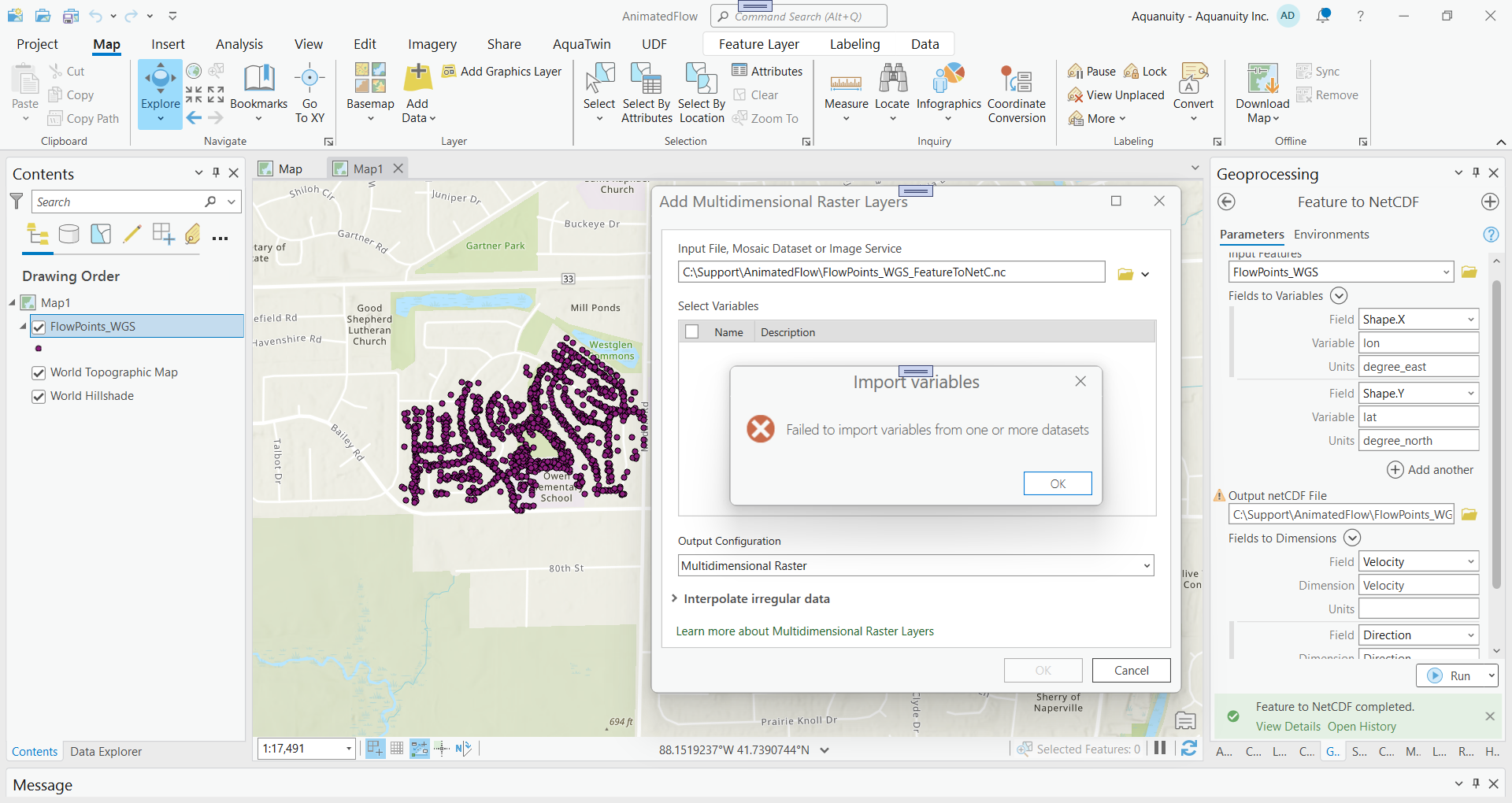

I have some difficulties to create a NetCDF file from point features using Feature to NetCDF GP tool. The following picture shows how I setup. The tool ran successfully but I can not load it into the map using Add Multidimensional Raster Layers. What did I do wrong? Any hints will be greatly appreciated. Attached is the point feature data from a geodatabase.

The Multidimensional Raster Layers tool is designed to work with raster data, not point data. I see you have point feature class, please try with animate symbol directly on your feature data. see the doc at Animate marker symbol layers—ArcGIS Pro | Documentation

@AquanuityDevelopment Please try the following steps:
1. Convert your FlowPoints_WGS to TIN, then to Raster, and finally to Point FC.
2. Convert your Point FC to the Geographic Coordinate System.
3. Use the following parameters for the tool: Feature to NetCDF
arcpy.md.FeatureToNetCDF(out_shp,[['Shape.X','lon'], ['Shape.Y','lat'], ['Shape.Z','z'], ['Depth','Depth']], out_nc, [['lon','lon'], ['lat','lat'], ['z','z']])
Hope it works.
